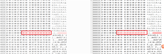

When using CPU2 of 28377D, use the emulator to download the generated out file to flash, and when viewing memory, there is a 0xFFFF in memory, but when Vscode opens the corresponding bin file, the corresponding position is not 0xFFFF。As shown in the figure below, 4 0xFFFF are missing from the bin file

    Where does this bin file come from?  Please show the text, and not a screenshot, of the command used to create it.

  • Use CCS to enable the bin file generated by "Enable C2000 Hex Utility".The settings are as follows:--memwidth=16 --order=MS --romwidth=16 --diag_wrap=off --binary。Also, CPU1 cores don't have this problem if they use the same setup。
    Is there anything special about CPU2, or is there an official setup tutorial?
  • A binary file created by ...
    ... has a problem.  Any gap in memory between sections is ignored.
    Please use the workaround described in this forum post.  Among other details, this workaround requires adding a hex utility command file to the CCS project.  For the details of how to do that, please see the last part of the article Hex utility in CCS.

  • I have changed the way to generate bin files.
    post build, I use: "${CCE_INSTALL_ROOT}/utils/tiobj2bin/tiobj2bin" "${BuildArtifactFileName}" "${BuildArtifactFileBaseName}.bin" "${CG_TOOL_ROOT}/bin/ofd2000" "${CG_TOOL_ROOT}/bin/hex2000" "${CCE_INSTALL_ROOT}/utils/tiobj2bin/mkhex4bin"
    CPU1 and CPU2 use the same method, CPU1 has no problem with the bin file (the bin file is exactly the same as in the memory view)
    However, there is a problem with CPU2: for example, after the JATG is downloaded, the data viewed in the memory view is FFFF FFFF FFFF, but the bin file is 0000 0000 0000
  • The workaround I referred you to does not use tiobj2bin.  Because tiobj2bin has problems.
    One, it doesn't work with C2000 EABI files.  I presume you build with EABI, so I don't know how you got it to work.
    Two, gaps are always filled with 0.
    If you use the workaround I suggest, it fills gaps with 0 by default.  But you can change that default by adding the option --fill=0xffff to the hex2000 command.
