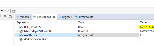

I configured a watchdog for the CPU1: it generates an interrupt, and a reset is asked in its ISR. The main while loop for this CPU executes only a simpel task (led blinking and scalar product), and a call to a "freezing" function. This finction makes the program enter in a infinite loop if the global variable uint16_freeze is set.
I want to test this:

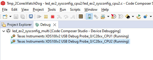

1) I open a debug session

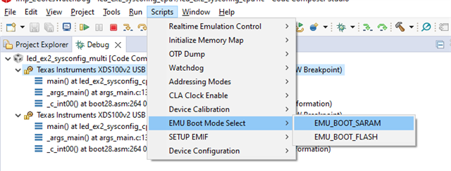

2) I select the right EMU mode for each project:
3) I launch the two projects
3- I force the freezing of the programm

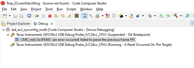

=> The CPU1 is halted because of an error:
Can somebody tell me what I did wrong ?

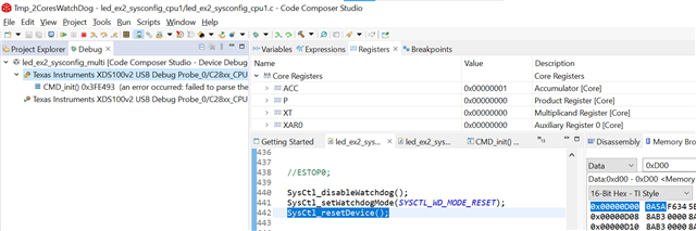

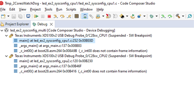

    I ask for a reset of CPU1 doing this: SysCtl_resetDevice();
    This command should reset both CPU1 and CPU2. Looking in the registers I can see that, when the debug sessions stops:

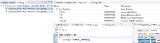

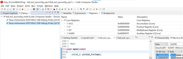

    For the RAM config, it is controlled by EMU_BOOT_CTRL, so in the PIE area. When executing the script, 0x0A5A is written at 0x0D00 before the reset.
    You say that the RAM is erased, but after the freeze, I still can read this value in the RAM:
    Can you make the test on your side ?

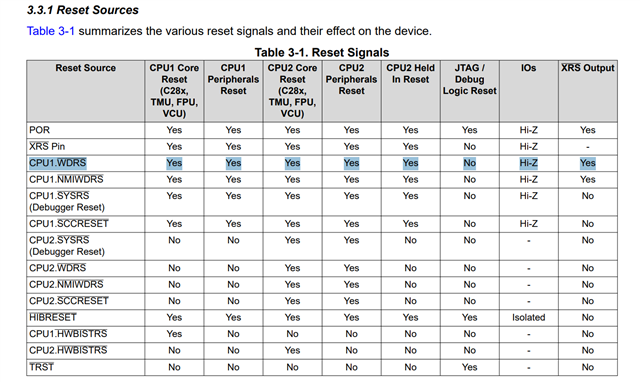

    You are correct - apologies I misread the watchdog reset does not clear/initialize RAM contents as it is considered a warm reset on this device.
    I see the EMU key is present. To clarify, can you confirm the registers are being programmed with the correct EMU boot mode as well for both CPUs? What is your EMY_BMODE?
    Allison
  • Hello Allison,
    Yes, I do confirm that:
    As you can see, 0x0A (boot at 0x0000, RAM)
    Please, can you run the Archive I sent. I really don't think that this message deals with bootrom flow:
    No source available for "CMD_init() at C:\Users\v.liebart\C2000_Projects\GENERIC\Tmp_2CoresWatchDog\led_ex2_sysconfig_cpu1\RAM\led_ex2_sysconfig_cpu1.out:{3} 0x3fe493{4}"
    *Correction*
    As per the F2837xD TRM:
    All RAMs are cleared on WDRSn by the device boot ROM. I've confirmed this is the case with the application archive you provided.

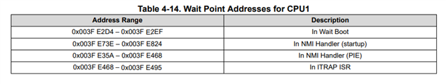

    Address 0x3FE493 is where the ITRAP ISR is located in the boot ROM. Since the application's code start is cleared at 0x0 (M0 RAM) on WD reset, when the device branches to 0x0 in RAM boot with no instructions provided at that address, an ITRAP is hit.
