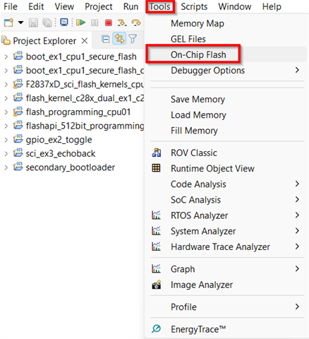

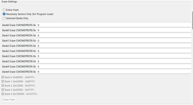

    1. My Bootloader should flash to Bank0 from CCS without disturbing any other banks
    2.My Application should flash to Bank1 &2  from CCS without disturbing any other banks
    For (1) and (2), please navigate to the "On-Chip Flash Tool" while connected to the device:
    1. Go to Tools > On-Chip Flash
    2. Scroll down to "Erase Settings" in the On-Chip Flash tool and select "Necessary Sectors Only (for Program Load)". This will ensure that the application/bootloader do not erase the other during programming. You can also select which banks you want to be erased during programming with the "Selected Banks Only" setting.

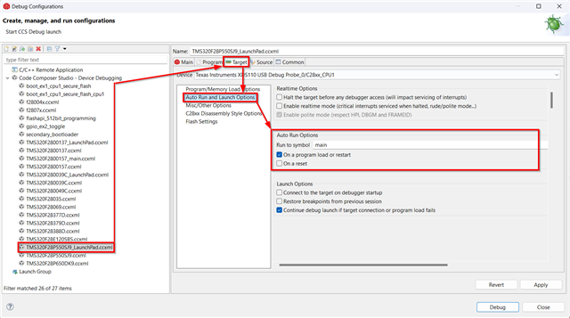

    3. Application should not boot by its own
    This is due to the debug configuration settings defined in CCS, which auto-runs to main (of the programmed application) on program load/restart. You can view this setting by navigating to Run > Debug Configurations, and selecting your target configuration ccxml:
