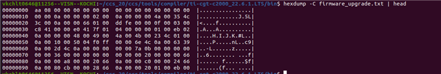

    The binary i am trnsfering is a .txt file now
    hex2000 -boot -b -o firmware_upgrade.txt firmware_upgrade.out
    Is this correct or should we transfer firmware_upgrade.out itself?

    • When I programmed the .bin to address 0xA0000, the flash dump showed the exact hexdump data correctly stored --> But not jumping to APP(code provided). After getting exact flash dump of the .bin file why its not booting?
    • However, when I programmed it to 0xA0002, the flash dump only showed 0xFFFF.
    To clarify: 0xA0000 - 0xA0001 is reserved for the codestart and 0xA0002-0xA0007 is reserved. The rest of the bank can be used for the application.
    Please start programming the binary file from 0xA0000 (with the codestart at 0xA0000). The flash boundaries need to be aligned to 512-bits for 512-bit programming to work, which is why starting from 0xA0002 fails.
    Regarding the on-chip tool to verify whether the programming is done correctly, could you please share any reference link or documentation?
    Please refer to this FAQ for more details on how to access the on-chip flash tool in CCS and verify the flash.

  • Hi Matt,
    I have dumped the content in flash memory  when i flash via CCS and via my custom boot loader(using FAPI APis).
    Note:- Checked for different firmwares in different banks
    1. flashing application via custom bootloader
           1. Build the .out file from CCS
           2. hex2000 -o AIO_CLI_4_real.bin -b -i AIO_CLI_4.out
           Is this correct? if not give me the correct commnad to generate .bin file whih i can use to write to the board using FAPIs

    Since I am obtaining a full dump from flash that matches the .bin file hexdump exactly, I suspect that the conversion using hex2000 for the application code might be incorrect. Could you help me verify this? Also, what should be the first byte for the jump to the application to work correctly? Could the codestart setting be causing any issues?
