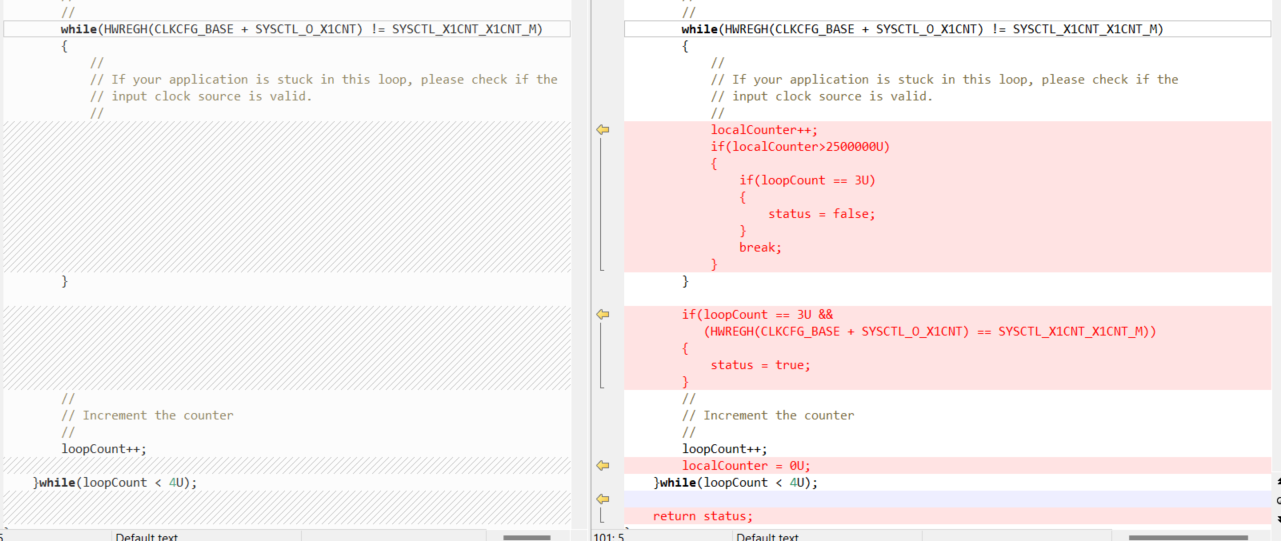

1) when waiting for X1 clock to saturate
added a timeout option to exit the loop :

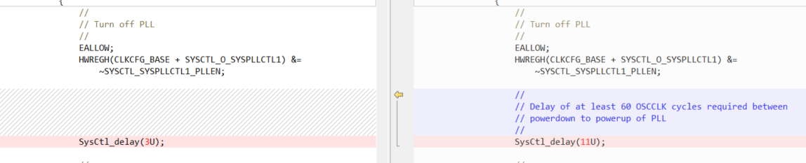

2) when turning off the PLL
added a Delay of at least 60 OSCCLK cycles required between  powerdown to powerup of PLL

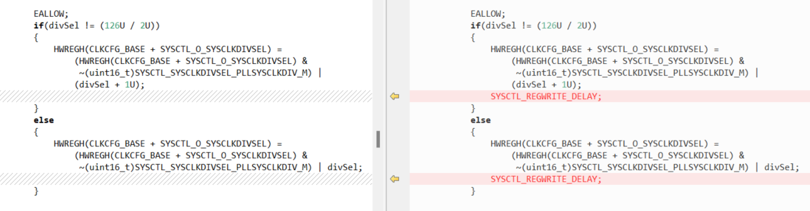

3) when writing the divider in SYSCTL_O_SYSCLKDIVSEL / SYSCTL_O_XTALCR / SYSCTL_O_CLKSRCCTL1 registers
added a delay
SYSCTL_REGWRITE_DELAY i.e.  asm(" RPT #39 || NOP")

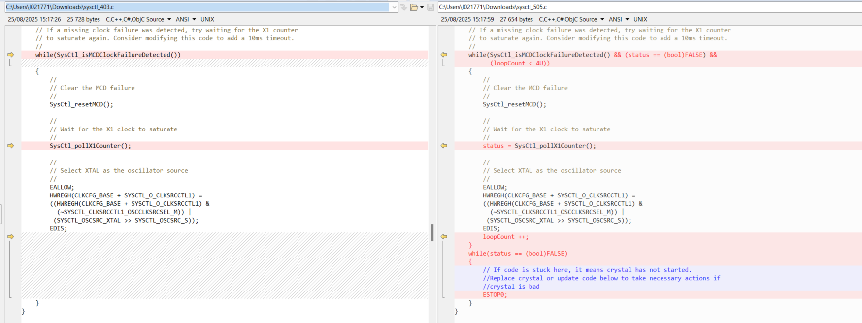

4) When checking missing clock failure
added a counter option to exit the loop , and stop the program execution

    As per the datasheet, there should be a 60 cycle wait after PLL is power down. Please have a look at the E2E - (+) TMS320F280049C: C2000Ware v4 uses 24 cycles instead of 60 cycles for PLL turn off - C2000 microcontrollers forum - C2000Tm︎ microcontrollers - TI E2E support forums
    Regarding the SYSCTL_REGWRITE_DELAY, please have a look at the "System control register configuration restriction" section in the TRM where it mentions regarding the delay between subsequent writes between certain sysctl registers. We have added the delay based on the TRM descriptions.

    It worths for 2 writes on the same register (like SYSCTL_O_SYSCLKDIVSEL displayed above) or 2 writes on any registers listed in table 3.19 ?
    The delay is added between subsequent writes of the registers in the table, otherwise the second write can be lost.
    As per the TRM, you need to add the delay so that proper write is happening to the registers without any failed case.
