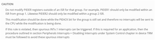

    As a note, you never want to write the PIEIER of a different group inside an ISR. This can cause unexpected behavior. For this reason, you do not want to write to PIEIER12 inside of your ADC ISR (from group 1). See warning below:
    Based on your current code, it would be expected that the CPU timer 2 interrupt doesn't nest inside the ADC ISR since TIMER2 is in group 14 and nesting has not been enabled for this group. Let me know what kind of nesting you are trying to do, and which interrupts are enabled, and I can provide some recommendations.
    Have you tried removing the below lines of code and seeing if the problem persists?
            // PIEIER12: disable all interrupt of group 12
            // except the flash correctable error interrupt.
            HWREGH(PIECTRL_BASE + PIE_O_IER12) &= PIE_IER12_INTX11;
            // Restore interrupts registers.
            HWREGH(PIECTRL_BASE + PIE_O_IER12) = pieier_prev;
    Delaney
  • Hi Delaney,
    Yes, I have tried removing those lines, but the problem still persists.
