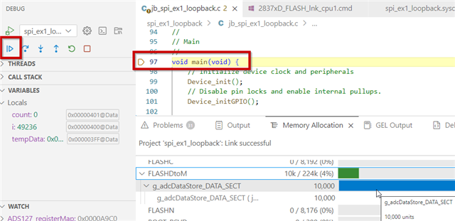

LAUNCHXL-F28379D: TMS320F28379D hangs when running the debugger -- OK if array size is small
Part Number: LAUNCHXL-F28379D
I need to store a large array in FLASH memory but I am finding that the debugger never reaches the initialized state where you hit the "Continue" blue button. Same story with directly programming the FLASH, it doesn't go through.
For example, this works:
const uint32_t g_adcDataStoreSize = 10e3;
#pragma DATA_SECTION(g_adcDataStore,"g_adcDataStore_DATA_SECT")
uint16_t g_adcDataStore[g_adcDataStoreSize] = {0};
GOOD!
This does not work:
const uint32_t g_adcDataStoreSize = 100e3;
BAD!
Left hanging, I never hit the "Resume" button and the code does not run. I know that the flash did not get written properly because I have a GPIO pin to set high as a test.
You can see in the picture there is plenty of space in FLASH memory, no build errors either.
Is there something improper in my .cmd file? Something else wrong?

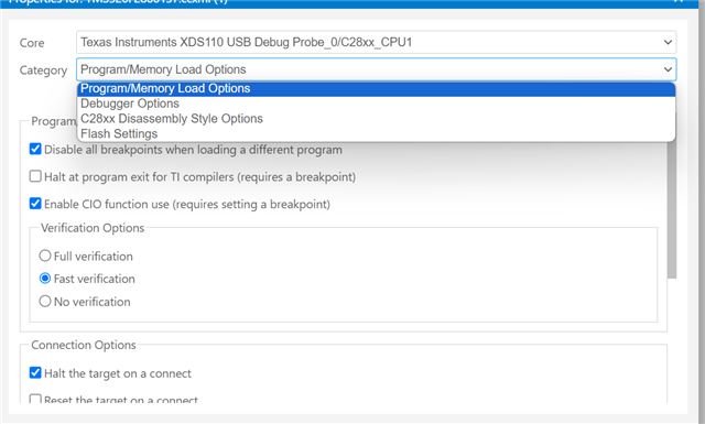

    Pls clarify the following questions that may help in narrowing down the cause for this issue
    1. Is it possible for you to share the .map file generated after compilation for the large array?
    2. What is the error that is displayed during the Flash operation? Does it just hung or you see any output in the console output window?
    3. You can enable the "Verbose output" option under the Flash settings and see if throws any error
    You can enable this by right clicking on the Connected core under the Threads section in the Debugger view, browse to Properties and then select the "Flash settings" option and then scroll down to enable the Verbose output option

    2. No text observed in the "Output", "GEL Output", "CIO", and "Debug Console" windows. No visible errors observed in the "Debug Output" window.
    3. "Debug Output" window after enabling verbose:
    C28xx_CPU1: If erase/program (E/P) operation is being done on one core, the other core should not execute from shared-RAM (SR) as they are used for the E/P code. Also, CPU1 will be halted to determine SR ownership for the CPU which will run the Flash Plugin code, after which CPU1 will be set to run its application. User code execution from SR could commence after the selected flash banks are programmed.

    It just hangs:
    Do you see anything wrong?
