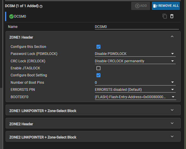

    The assembly code was automatically generated when inserting the following syscfg config:
    Is it possible to generate a .hex which only changes the mentioned sections ? If so how can I achieve it? Maybe through the .cmd?
    Many thanks for the quick response :)

  • For this question I will defer to the compiler (hex utility) experts. I will bring this thread to their attention.
  • Is it possible to generate a .hex which only changes the mentioned sections ?
    Yes.  Use a SECTIONS directive instead of a ROMS directive.  Please search the C28x assembly tools manual for the phrase hex conversion utility SECTIONS directive.
