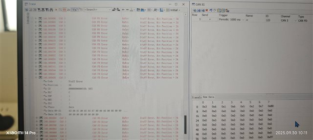

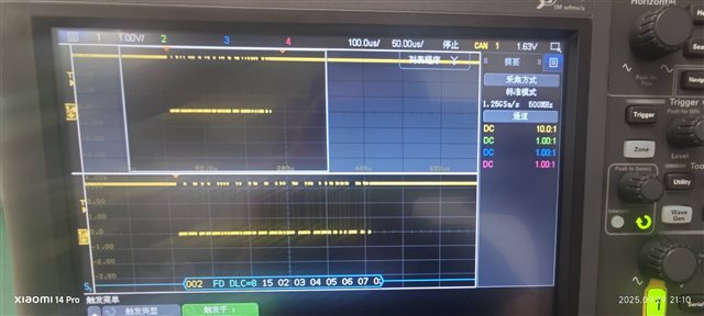

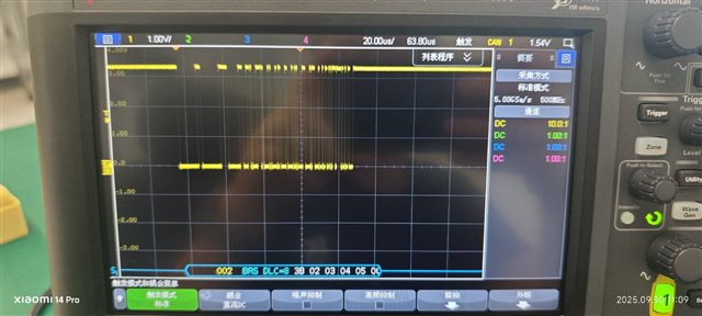

  • hello, I don't find how to set BRS in my scope, but i did another thing:
    1. I send a CANFD BRS message by my canoe IG,and the CANOE trace shows no err;
    2. I test the message at the CAN transceiver RX Pin and GND, there is no err and can see the BRS at the scope;
    3. the CANOE and the oscilloscope sample point is 80%,the data rate sample point also is 80%;
    base on the above, i think the oscilloscope and the CANOE is a correct config.
    i want know  if there is something wrong with my  MCAN config ? in ssp, in sjw?
    and i suspect my MCAN message RAM config maybe has wrong, I set the DLC is 8, but the CANOE trace shows the err frame DLC is C;
    can you help me check the message RAM config or the SSP set point or other config?
    below is my message RAM config and some test picture;

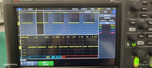

  • I have find the incorrect place, the CANOE and the scope sample point both 80%, and arbitration is 500Kbps, the data is 2Mbps,
    but the software config is:
    bitTimes_myMCAN0.nomRatePrescalar = 3; // Nominal Baud Rate Pre-scaler.
    bitTimes_myMCAN0.nomTimeSeg1 = 9; // Nominal Time segment before sample point.
    bitTimes_myMCAN0.nomTimeSeg2 = 8; // Nominal Time segment after sample point.
    bitTimes_myMCAN0.nomSynchJumpWidth = 7; // Nominal (Re)Synchronization Jump Width Range.
    bitTimes_myMCAN0.dataRatePrescalar = 1; // Data Baud Rate Pre-scaler.
    bitTimes_myMCAN0.dataTimeSeg1 = 9; // Data Time segment before sample point.
    bitTimes_myMCAN0.dataTimeSeg2 = 8; // Data Time segment after sample point.
    bitTimes_myMCAN0.dataSynchJumpWidth = 7; // Data (Re)Synchronization Jump Width.
    while i change to the list config, there is no can err;
    bitTimes_myMCAN0.nomTimeSeg1 = 14; // Nominal Time segment before sample point.
    bitTimes_myMCAN0.nomTimeSeg2 = 3; // Nominal Time segment after sample point.
    bitTimes_myMCAN0.nomSynchJumpWidth = 3; // Nominal (Re)Synchronization Jump Width Range.
    bitTimes_myMCAN0.dataRatePrescalar = 0; // Data Baud Rate Pre-scaler.
    bitTimes_myMCAN0.dataTimeSeg1 = 14; // Data Time segment before sample point.
    bitTimes_myMCAN0.dataTimeSeg2 = 3; // Data Time segment after sample point.
    bitTimes_myMCAN0.dataSynchJumpWidth = 3; // Data (Re)Synchronization Jump Width.
    so the err is  caused by the wrong  sample point, and the MCAN example project maybe  has unsuitable config;
    another question is that  how to calculate the sample point?
    is
    1- nomTimeSeg2 / (nomTimeSeg2 + 1 + nomTimeSeg1  + 1 + 1)
    or
    1- (nomTimeSeg2 +1)/ (nomTimeSeg2 + 1 + nomTimeSeg1  + 1 + 1)?
  • Bit rate (nominal or data) is calculated as follows:
         BR = (MCAN Clk/(RatePrescaler + 1))/(TimeSeg1 + TimeSeg2 + 3)
         In the SW example MCAN Clk = 120MHz/(MCLK divider = 3) = 40MHz
    Sampling Point is calculated as:
         SP = (TimeSeg1)/(TimeSeg1 + TimeSeg2)
    The first config parameters are:
         Nom BR = (40MHz/(3+1)) / (9 + 9 + 3) = 500kbps
         Data BR = (40MHz/(1+1)) / (9 + 8 + 3) = 1Mbps
         SP = (9)/(9 + 8) = 53%
    The second config parameters are:
         Nom BR = (40MHz/(3+1)) / (14 + 3 + 3) = 500kbps
         Data BR = (40MHz/(1+0)) / (14 + 3 + 3) = 2Mbps
         SP = (14)/(14 + 3) = 82%
    Obviously, the first config parameter will not work if CANOE is expecting nom rate of 500kbps and data rate of 2Mbps
