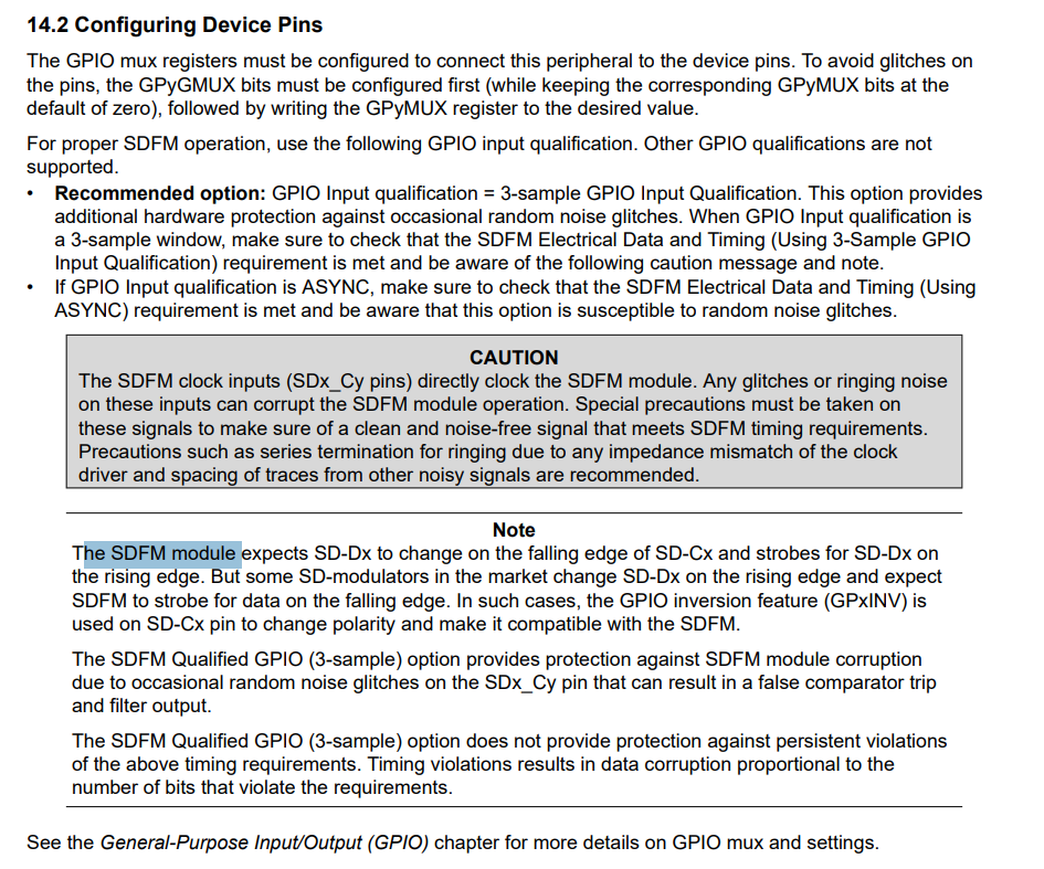

We are evaluating the AMC3306M05 and we seem to be having issues with noise in our control loop when it is recovered from the TMS320F28379D MCU at certain duty cycles, or the current changes directions. We are using our ePWMs to synchronize our sensing and have a compare value set to approximate the latency of the SINC2 OSR128 filter we are using. We are using the SDFM Qualified GPIO 3 Samples option hoping to remove glitches, but it has not impacted our situation. We have looked at the data visually w/ a 500MHz Optically Isolated Probe and cannot see any substantial fluctuation in the data input to the TMS320F28379D waveform. However when the signal is filtered through the SDFM we receive a step response in the signal.
I posted this to the SDFM forum, and the observation was that the AMC3306 is working as intended. I have checked my gate signals on the switching bridge and that also does not seem to have an impact, they are seeing the step response read by the MCU SDFM Input. (See thread: https://e2e.ti.com/support/data-converters-group/data-converters/f/data-converters-forum/1589906/amc3306m05-q1-sdfm-data-glitch-occuring).
How would we be able to determine if we have a glitch related to timing violations vs noise on the input of the CLK/Data? Are their any suggestions to verify the SDFM is faulted?

    You have mentioned that you looked at the “data and cannot see any substantial fluctuation in the data input”. Can you also probe the clock right at the MCU pin?
    SDx_Cy directly clocks the SDFM when GPIO async is used, and ringing that cross VIH/VIL can corrupt the SDFM and cause unpredictable results. This can show up as a sudden step in the filtered output because a single extra/missing clock edge effectively “bit-slips” the decimation stream.
    Also, make sure the PWM is free-running (not a clock that can be momentarily disturbed by duty-cycle updates or sync events elsewhere).
    Masoud

  • Hi Noah,
    Apologies for the late reply! Many team members are out of the office this time of year.
    What I understand is that you’re not seeing obvious corruption on SDx_Dy with the scope, but you do see intermittent step behavior after the SINC2/OSR128 filter, especially around switching events and current direction changes.
    The SDx_Cy (clock) can corrupt the SDFM even if DOUT looks fine. On F2837xD, the SDFM clock input (SDx_Cy) can directly clock the SDFM module (no internal synchronization in ASYNC mode). The errata explicitly warns that glitches/ringing that cross VIH/VIL on SDx_Cy can corrupt the SDFM and cause unpredictable results.
    Please probe SDx_Cy at the MCU pin (not only at the source) with the shortest ground possible and look specifically for runt pulses / ringing that crosses VIH/VIL during switching edges. This can be very narrow and still be real to the digital input. Also you  can add series termination at the clock driver and keep SDCLK away from high dv/dt nodes.
    The same errata recommends using SDFM GPIO qualification (3-sample) in noisy conditions because it filters both SDx_Cy and SDx_Dy. It also calls out that you must follow the SDFM timing requirements when using qualification datasheet table.
    So if you enabled “Qualified GPIO 3 Samples” but didn’t see improvement, double-check that qualification is actually applied to the pins used for SDx_Cy and SDx_Dy and confirm your SDCLK frequency + qualification settings satisfy the datasheet’s qualified-input timing.
    If your “synchronize sensing with ePWM” includes using PWM FILRES to reset/synchronize the SDFM data filter, there is an errata item: a spurious data acknowledge (AFx) can occur before the filter settles. The workaround includes ensuring the CPU/CLA interrupt occurs ≥ 1.2 µs after FILRES and clearing SDIFLG appropriately.
    Masoud
