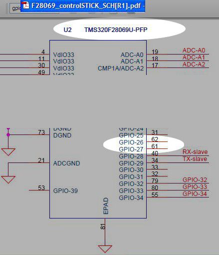

  • Alvaro, thanks a lot. What kit can be used to eval the USB functions of 2806xU?
    John

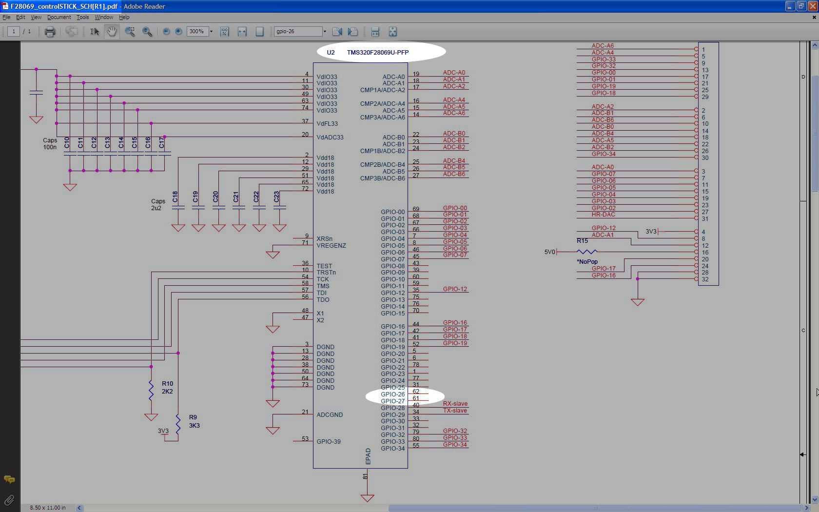

    I would expect to see this product in the TI eStore, but I don't:
    TMDXCNCD28069ISO - F28069U Piccolo USB controlCARD

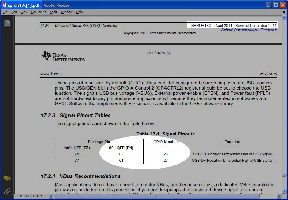

    The TMS320F28069 controlSTICK appears to use the USB variant of the part, the TMS320F28069U.  However, pins GPIO-26, GPIO-27, that would have USB are not connected.

  • For anyone who's interested, not all (if any?) of the '28069 ControlSticks are populated with USB variants of the chip. I was hoping to hand-solder the unconnected USB signals, but the part on mine is a '320F28069PNA.
