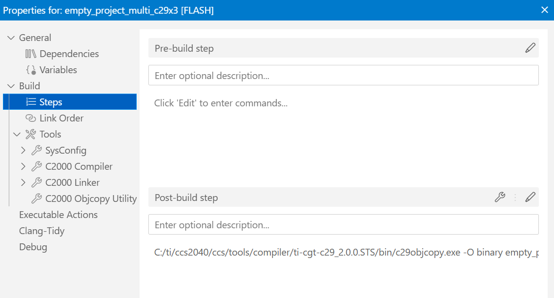

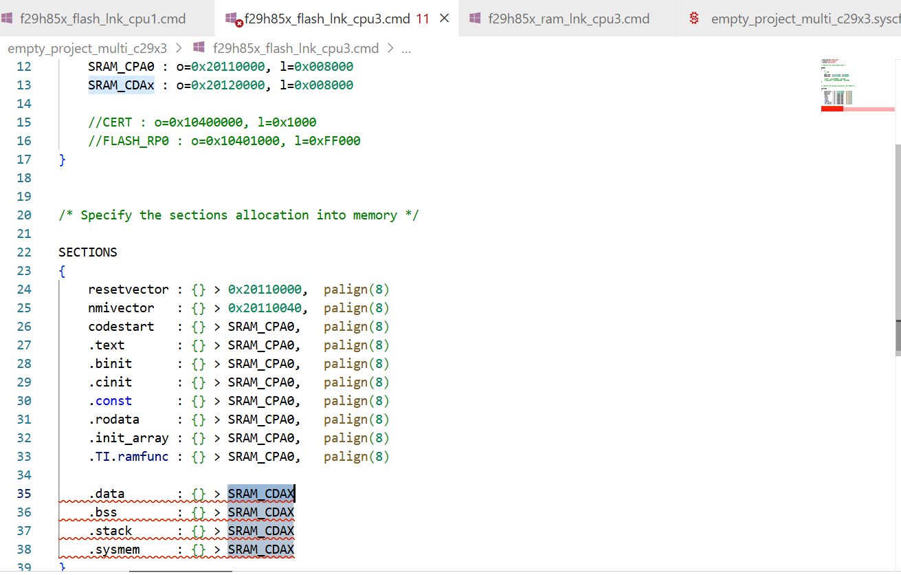

We provide the empty multi-core project work in bankmode2, but my customer want empty multi-core project work in bankmode1(cpu3 can't access flash)
So I want to modify the project based on empty multi-core project we provided in SDK
1.modify the cpu3 cmd:
2.modify the cpu1 cmd:
3.modify the cpu1 steps
but still fail because of below error.
I also upload the project I modified: empty_project_multi_c29x1.zip
Coud you help to give me a multi-core project work in bankmode1?
