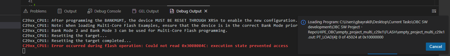

Now, although this sequence is working fine sometimes but, when I try to re-start this sequence there might errors pops up such as attached screenshot.
After this screnshot occurs, nothing happens the IDE just stuck there.
Then, i need to close the IDE, remove and reconnect the DOCK and XDS110ISO-EVM power conenctions. Even, sometimes I needed to restart the whole windows to succesfully debug again.

  • Another failure screenshot.
    When this happens, it is quite hard to fix. I needed to re-start all windows OS.
    Also, I have tried to decrease the JTAG TCLK frequency which decreases the first screenshot occurrence but did not make it zero fail.

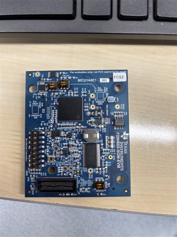

    Could you also please let me know the version of hardware you have? The F29H85x-SOM-EVM should have a marking on it to signify whether it is E1 or A revision along with a number designator (-001, -002, or -003).

    Usually, during load Programming of CPU1, there are various error pops up as shown above.
    I am sharing the picture of the board. I assume it is MCU144E1-003
    Thank you for providing the image. This is an early version of the EVM. I will check to see if I can get access to this version to also test on my side and see if I can replicate the issue.

  • Hi Gokhan,
    Thank you for your patience. I was able to locate an early version of the EVM and I can replicate the problem you are seeing. I've asked for new hardware to be sent to you. With the updated hardware you should not face this issue anymore.
