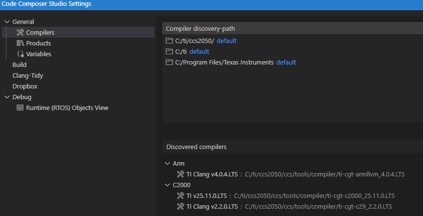

Compilers:
As can be seen, the Compiler discovery-path defaults to the latest installed version, and secondary to the c:\ti folder - but it discovers nothing more that the latest version. Adding for example c:/ti/ccs2041 (or a version with slashes the other direction) does nothing to discover the earlier compilers. And editing the c:/ti/ccs2041 path or changing the search order is not possible.

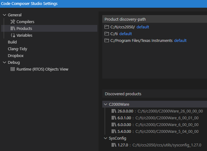

Products:
It's slightly better on this pane.
The C2000Ware versions are correctly discovered, and thereby available to use by the projects.
However, the SysConfig is suffering from the same issues as the Compiler, that only only the latest version is available.

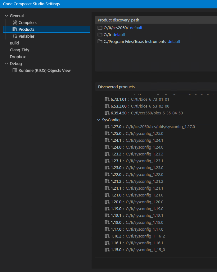

    My CCS 20.5.0 can detect many SysConfig versions:

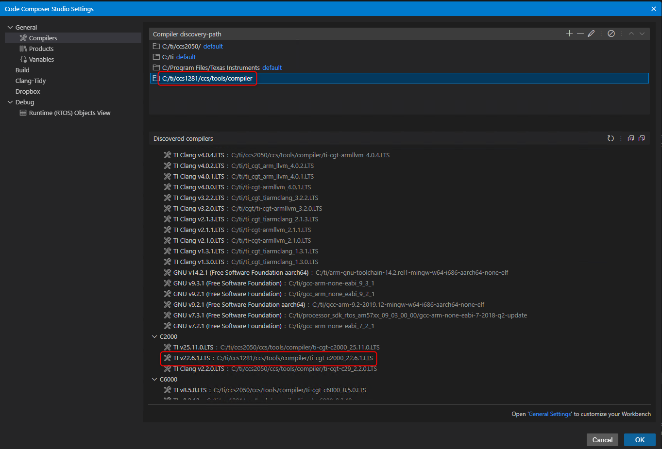

    Note that other than the current CCS installation directory, the discovery feature will only look in the current directory and one subdirectory level. If you want to find say the C2000 compiler from an other CCS version, try setting the search path as such in the example below:

    I notice in your case with sysconfig, that it does not find sysconfig in the folders where the CCS installer actually places them, ie.paths starting with  c:\ti\ccs2020, c:\ti\ccs2040, and c:\ti\ccs2041, etc.
    Most of the sysconfig's that you list are placed directly in the c:\ti\ folder, and do not follow the CCS install pattern.
    The only sysconfig you have that follow that pattern is the one in c:\ti\ccs2050, which I attribute to the default C:/ti/ccs2025/ discovery path, but in fact it is still strange, as I tried adding c:\ti\ccs2020, then C:\ti\ccs2020\ccs and only after adding the C:\ti\ccs2020\ccs\utils was it able to discover sysconfig_1.24.0
    This ought to work out of the box. And the install pattern is so simple that there is no reason it does not.
    Likewise with the compiler, I had to add a path of C:\ti\ccs2020\ccs\tools\compiler\ti-cgt-c2000_22.6.2.LTS for it to discover the 22.6.2.LTS compiler. Adding just C:\ti\ccs2020\ccs\tools\compiler as in your example was not enough.
    Again, this ought to work out of the box, with just c:\\ti\ folder in the discovery-path.

    All the ones in C:\ti root are the ones I downloaded and installed from Resource Explorer or I downloaded from ti.com and ran the install manually.
    The CCS discovery feature will search in the root location of any specified discovery paths and also one subfolder deep. This is to minimize performance impact that can happen when searching folders recursively. However, there are some locations CCS will also search in automatically inside its install directory and one is ccs/utils and the other is ccs/tools/compiler. Again this only applies to the CCS install directory for the current running CCS instance.
