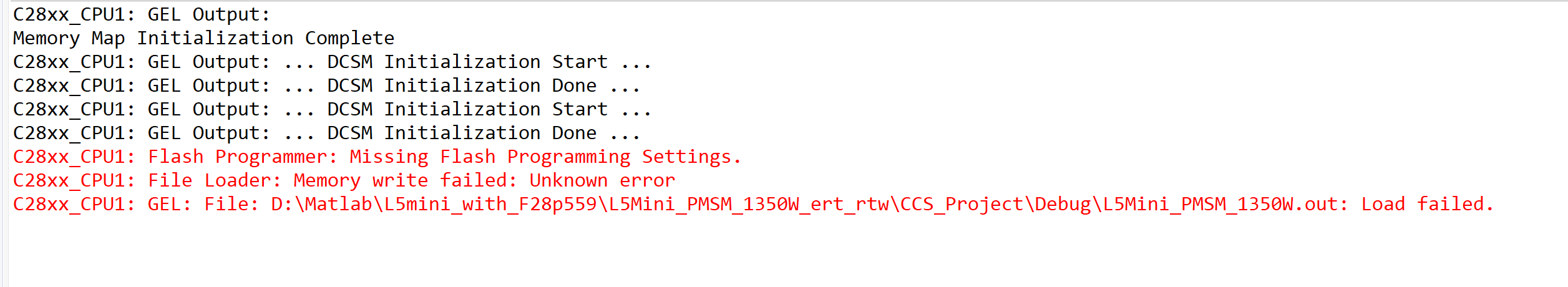

TMS320F28P559SG-Q1: Boot from Flash config not working - F28P559SG2
Part Number: TMS320F28P559SG-Q1
Hi Team,
I'm having this issue of XCP not working over SCI-A when booted from Flash with configuration GPIO28 - SCIA_RX and GPIO29 - SCIA_TX. Attached is the error screenshot and memory command files for defining memory.
When we using same memory allocation and SCI-A configuration on F28P55x LaunchPad, I'm not getting this issue and I can debug using SCI. But when we are using F28P559SG2-Q1 MCU on our board we have the mentioned issue.

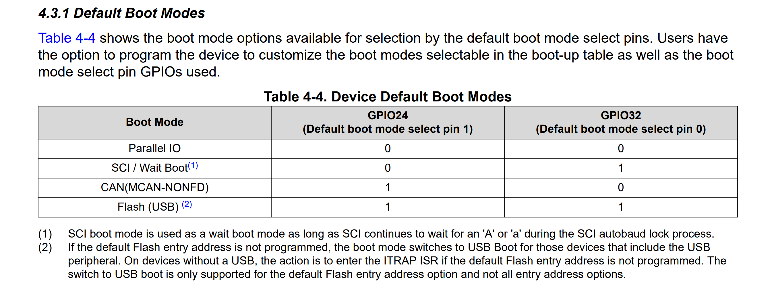

Also please clarify boot selection for F28P559SG2 for setting to Flash mode without having USB application. We have setted GPIO24 and GPIO32 as 1 in this case for flash selection.
Thanks & Regards,
Shubham Shriram
Boot mode selection.pngcmd file memory alloc.docx
    Your configurations seem correct. Setting GPIO24 and GPIO32 both high will configure a boot to flash. If the default flash entry point 0x80000 is unprogrammed, only then will the USB bootloader be invoked. Please verify that 0x80000 is programmed in the CCS memory browser.
    What version of CCS are you using? Please update to the latest eclipse-based IDE v12.8.1 if possible.

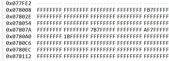

  • Hi Matt,
    We have verified the mentioned address in the memory browser.
    Following is the screenshot of 0x078008 & 0x078008C. However we cannot program it, kindly let us know how to program this location.

    There should be no need to program the OTP with new boot configurations if you wish to boot to 0x80000. This is already offered by the default boot mode.
    Can you please confirm this?
    Matt

    Yes, we want to boot from 0x80000 and not intend to program OTP.
    We are using Matlab MBD and CCS version in Matlab is v12.8.1.
    As mentioned earlier, when same code with same boot config used on Launchpad F28P55x (MCU F28P550SJ9) there is no XCP issue. But when I'm trying it on my board with MCU F28P559SG2 this issue occurs.
    Thanks & Regards,
    Shubham Shriram
    This sounds like a problem with the device support files in CCS. Please the replacing the following file in your CCS install folder (from latest CCS v20.5):
    • ccs1281\ccs\ccs_base\common\targetdb\devices\f28p559sg2-q1.xml
