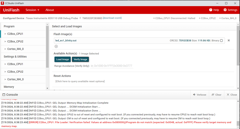

I am using the dcan_flash_programmer, and it executes without reporting errors; however, I do not see the expected blinky behavior on the F28388D controlCARD when programming completes. I have attached a ZIP containing both my CAN flash kernel code and the modified dcan_flash_programmer for review.
I have made a second stage CAN bootloader or kernel to flash an application image onto the F28388D over CAN. This was done by using the provided SCI kernel and swapping or changing the protocols to CAN. The application image that I am flashing is the led_ex1_blinky example provided by TI for the F28388D with no alterations.
The SCI-8 formatted txt files for both the kernel and application image were generated using CCS Theia version 20.5.1 using the hex utility. The scope is also only to flash to CPU1.
I have been using TI's dcan_flash_programmer provided in the C2000Ware (V 26.01.00) utilities with small modifications to support F28388D. These changes were strictly secluded string validation updates and a boolean addition to mimick the validation behavior of the other MCU's, nothing that should impact data parsing, formatting, or transmission logic.
The flash programmer builds successfully and appears to complete both kernel and application loading phases. However, after completion,  D1 (LED 1) on the F28388D control board does not blink suggesting a failure occured somewhere in the process without tirggering explicit logic errors.

Questions:
  1. Is there some other limitation to the dcan_flash_programmer that I have over looked that could explain this symptom?
  2. Is there something missing in my custom kernel that I need to include?
  3. Is there something wrong with my CAN protocols?
  4. What are some possible causes for this issue?
