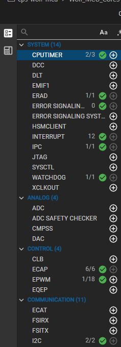

Where can I find the clock configurations in syscfg.
I am using CCS 20.40.1
I can't find the clock icon

Thanks for reaching out. The Clock Tree Tool in SysConfig is where you'll configure SYSCLK, MCANBDIV, and related clock parameters for the F29H850TU 1.
If the Clock Tree tab isn't visible in your current setup, this typically indicates a version mismatch between CCS, SysConfig, and C2000Ware. I'd recommend:
Update your toolchain to ensure compatibility:
Refresh product discovery in CCS: Go to Window > Preferences > Code Composer Studio > Products and click Refresh. This ensures CCS recognizes all installed tools and plugins.
Import your existing .syscfg file into the updated environment—your configuration will carry forward.
Once updated, open your .syscfg file and you should see the Clock Tree tab where you can select your clock source (SYSCLK, XTAL, INTOSC2) and configure dividers like MCANBDIV.
Let me know if the Clock Tree tab appears after updating, or if you hit any other issues.
