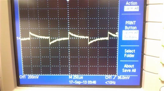

  • Also, I in trying to probe the ePWM1a output on the DIMM-100 connector, I get the following output at 50% duty cycle. Does anybody know why it looks like this? It almost looks like the signal decays to zero over each square wave.

    On your waveform, I would suspect that your oscilloscope is in AC-mode.

    As for the waveform, I thought that at first, but I had checked and it is not in AC coupling.
  • I just tried probing GPIO 6 with ePWM4 active, and it works (Thanks Brett).
    However, it's the same decaying signal, and the amplitudes are half of what I get by probing GPIO-0 on the DIMM100 connector. Is there an output amplifier for the DIMM 100? I don't see one in the schematic.

    I can almost guarantee that the signal does not actually look like that.  Either your setup or the oscilloscope are wrong.

    Well, I've also been talking with TI support and they don't have an idea either. I'd like to point out again that I am using the controlcard, whereas the lab uses the experimenter's kit. Perhaps there are extra hardware settings on the docking station breakout board? Any Jumpers?
  • Michael,
    How are you powering the device?
    (perhaps powering the device via J2 and providing the emulation connection via J20?)
    -Brett
  • Yes, I think that's right. Powering via microUSB attached to development computer, emulation via miniUSB also attached to development computer.
  • Wow, just tried ePWM1b, and the output looks perfect. Something wrong with the "a" side?
  • Okay I am getting somewhere, though I don't know where. With your help we may be able to get this.
    I copied the code for ePWM1 through ePWM4. I only modified the frequencies, so that I can tell them apart easily.
    Now, I can measure what I believe to be ePWM1b, ePWM2b, and ePWM3b, each of which look perfect. Nothing else looks right.
