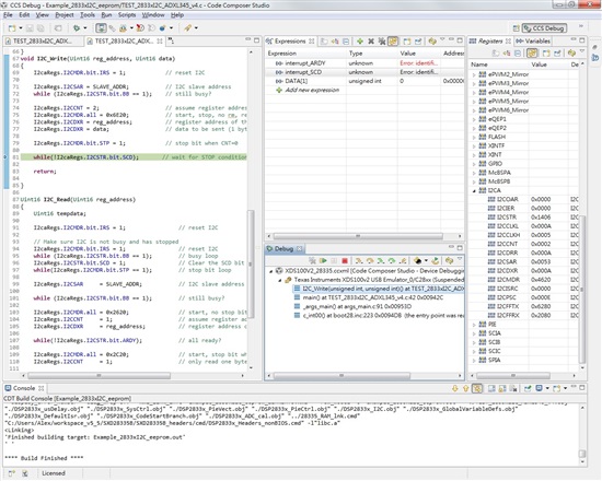

  • HI everyone
    In here, i'm so appreciate everyone take care my problem but i can't find my mistake still.

  • Hello Alex,
    Can you try this file and let me know what you observe using debugger (for example if it is stuck, in which line it is stucked, and give the screenshot of the I2C registers content).

  • HI Maria Todorova
    Here is the result. Coding is stuck in "while(!I2c Regs.I2C START.bit.SCD);" and the register I2CDRR doesn't change

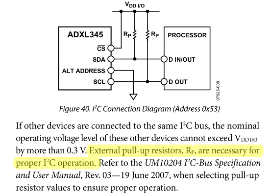

  • Hello Alex Huang,
    I am not sure you are understand about SLAVE ADDRESS or not.
    The SLAVE ADDRESS of this sensor (ADXL345) are only two options based on the datasheet (0x53 or 0x1D), this depends on  ALT ADDRESS pin.
    Please tell me how you connect your ADXL345 (schematic). Make sure your ADXL345 is setup (hardware) properly first, then you can continue to firmware.
    Also you can refer to this link about this sensor firmware (it provides code for Arduino)
    http://www.i2cdevlib.com/devices/adxl345#source
    Maria
  • hi Maria Todorova
    ok, i'm pretty sure if i change the SLAVE ADDRESS to 0x53 my signal will lost
    because i've use logic analyzer measure it.
    ok, I'll still try but  i'm so curious... have you ever use ti 28x dsp?
  • hi Maria
    here is my schematic, about ADXL345
  • Hello Alex,
    Can you put pull-up resistors for SCL and SDA? Because it is necessary, based on the datasheet.
    Maria

  • hello Maria
    Here is my circuit of ADXL345
  • hellow Maria
    I've try to use your code, but it's doesn't work
    it's can not get into the interrupt
    I write a new code, but i can't get into the ARDY interrupt when i'm read i2c data function.
