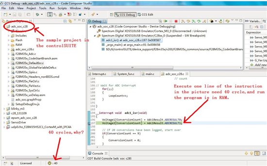

        When I debug the sample project "adc_soc_c28"in the controlSUITE,which located:
         \controlSUITE\device_support\f28m35x\v200\F28M35x_examples_Control\adc_soc
        ADC will trigger interrupt after conversion and read the adc result register,the problem is that execute one instruction that read the result register will need 40 clock cycles,why need so many? Please help me.
         And the picture is here.
   Thanks and Best regards!

  • Dear Gautam,
    My question is that why the CPU spend so many cycles(40 cycles)  on read ADC conversion result register one time. I think it should  be 2-5 cycles execute the instruction one time.
           " Voltage1[ConversionCount] = Adc1Result.ADCRESULT0;"

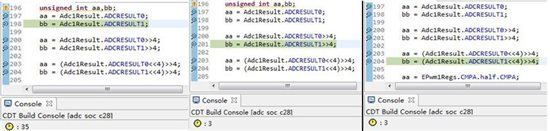

  • Dear Gautam,
          F28m35 ADC register is right-justified.
          Now,I debug like this:
    bb = Adc1Result.ADCRESULT1;   // It takes 35 cycles
    bb = Adc1Result.ADCRESULT1>>4;  // It takes 3 cycles
    bb = (Adc1Result.ADCRESULT1<<4)>>4;  // It takes 3 cycles
    It seems strange !
    Thanks and best regards.
    Lynn

  • Dear Gautam
         Yes,my doubt is that why "    aa = (Adc1Result.ADCRESULT0<<4)>>4;"takes 3 cyecles,but
         aa = Adc1Result.ADCRESULT0; takes 33 cycles.
    Thanks and regards
    Lynn

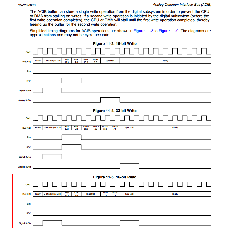

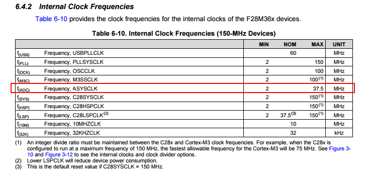

  • Hi Ionut,
    ADC result reads need to cross the ACIB.  The ACIB clock is typically 37.5MHz:
    The number of ASYSCLK cycles need for various operations are given in the TRM here:
  • You can also reference this thread to see if the DMA can help reduce your ADC result read latency: e2e.ti.com/.../1072786
