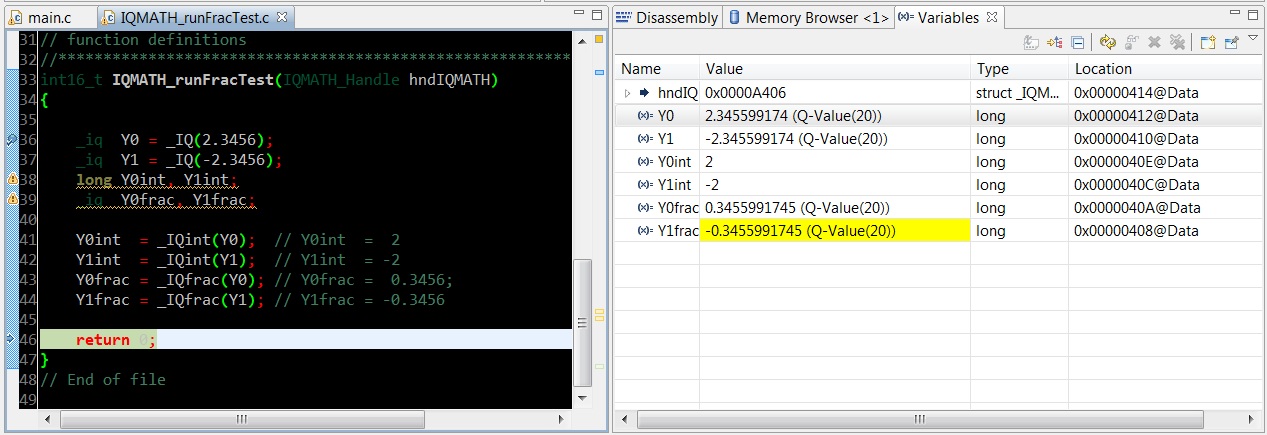

I have trouble with IQmath working.
_IQ iqTemp1, iqTemp2, iqTemp3, iqTemp4;
iqTemp1= _IQfrac(_IQ(2.3456));
iqTemp2= _IQfrac(_IQ(-2.3456));
iqTemp3= _IQfrac(_IQ(0.3456));
iqTemp4= _IQfrac(_IQ(-0.3456));
and I get the results are
iqTemp1= -0.3456; iqTemp2= 0.3456; iqTemp3= -0.3456; iqTemp4= 0.3456, the mark of the result is opposite. any ideas?

Thanks for your suggestion. Yes, I had check the example, But I can not get the same result, the mark of the result is always opposite.

That's very strange, Liu. Did you try with _IQxfrac like _IQ24frac?

I test the _IQ15frac, the mark of result is opposite. but the _IQint function is correct .

I figured out the problem after adding the latest compiler. It helped to point to the issue.
1. I was using the wrong compiler include: "C:\ti\ccsv5\tools\compiler\c2000_6.1.7\include" while using compiler 6.2.10
2. I was using the wrong IQMath.Lib resource file. My include is C:ti/controlSUITE/libs/math/IQmath/v160/include, but I was using c:\tidcs\DMC\c28\v32x\lib\dmclib\cIQmath\lib\IQmath.lib instead of C:\ti\controlSUITE\libs\math\IQmath\v160\lib\IQmath.lib.
Note: When I switched to 6.4.1, my project no longer fits. I'm sticking with 6.2.10.
