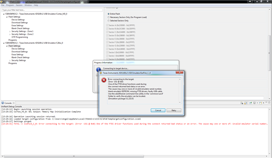

  • I cannot connect with C28 core in Uniflash tool in order to unlock the device.
  • Can you attach a screenshot of the alert window of Uniflash tool? I'm unable to understand by, what you mean by "I cannot connect with C28 core in Uniflash tool"

  • Thanks for your answer!
    I attach the information that Uniflash said to me.
    As you can see I can't connect with the C28 core and because of that, I can't erase and reprogram flash.
    Best Regards
