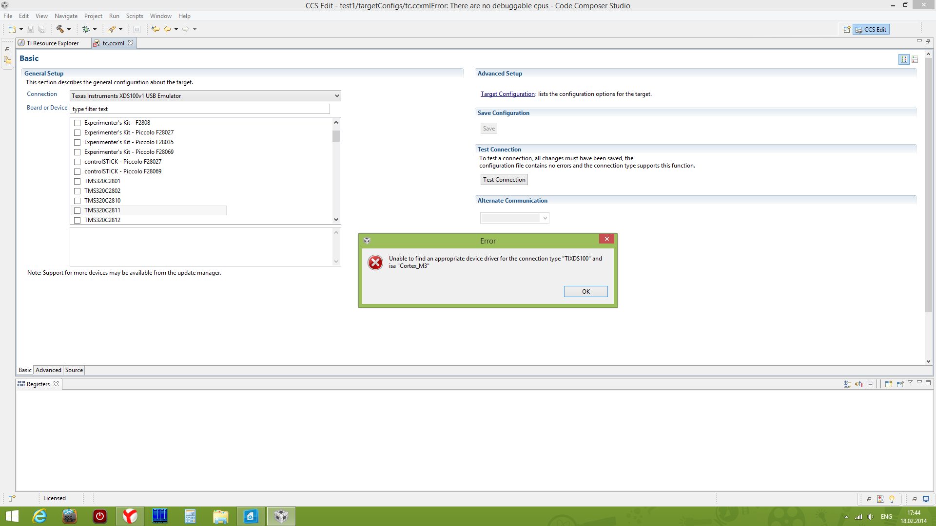

  • Hi Gautam!
    this is my target configuration screenshot
    As you  can see the emulator is "Texas Instruments XDS100v2 USB Emulator"
    there is no possibility to select F28M35 device in case I select XDS100v1 emulator:
    but in the WIN's device manager I see "Texas Instruments Inc. XDS100 Version 1.0 A" and "Texas Instruments Inc. XDS100 Version 1.0 B"
    May be I need to reinstall something?
    Roman
  • Hi Roman,
    Firstly, the F28M35x controlCARD has an on-card FT2232H-based xds100v2 emulator.  Therefore your target configuration is correct.  (xds100v2 + F28M35H52C1)
    I think the key thing to note here is that the card works with WinXP and CCS5.3 (it may be worth rechecking this to make sure this is still true).
    If you then move the Experimenter's Kit with the same hardware settings, cable connections and target configuration to the PC Win8 and CCS5.5.  If it fails now, this would point me toward issues with either CCS or the xds100v2 drivers on the newer Win8 PC.
    When you plug into the WinXP PC, does device manager show that Windows has assigned the controlCARD the same driver as in the Win8 PC?

  • As you  can see the emulator is "Texas Instruments XDS100v2 USB Emulator"
    Sorry for the misinterpretation, as Brett has mentioned it is FT2232H-based xds100v2 emulator. Do revert with what Brett has suggested.
