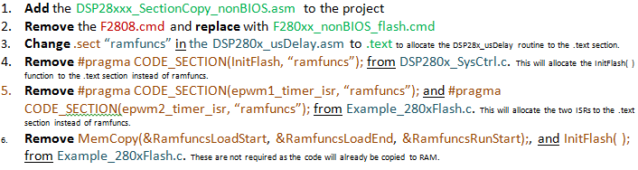

I am on a project with F28335, i don't really understand about .cmd file such as F28335.cmd, 28335_RAM_lnk.cmd, 28335_IQmath_lnk.cmd, 28335_fastRTS_lnk.cmd ....
I think it is program memory will be used. If you boot SARAM use 28335_RAM_lnk.cmd, flash: F28335.cmd.
In my project, I need a high precision, fast calculation with floating-point unit. So, I added IQmath, and
FPU fastRTS library. So I don't understand, If i want F28335 run from FLASH with these library what .cmd i must use and if i want F28335 run from SARAM with these library what .cmd i must use.
