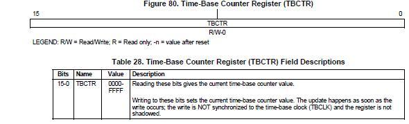

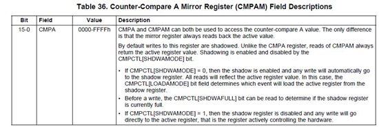

       you can read ePWM internal counter value .
           and in case you are using shadow mode or direct mode reading of CMPA (shadow resister / actual resister) will give you
    Current active value.
      If you are interested in active value of CMPA which will cause PWM to change their state you can read this resister.
    By comparing Counter value and CMPA determine in software which transition / state your PWM will take.

  • Hi Bhuvaneshwar.
    Excellent! It works!
    I did "a=EPwm6Regs.TBCTR;" in the timer interruption to obtain the counter value and then I use the variable 'a' to compare with other variable.
    Thank you a lot.
