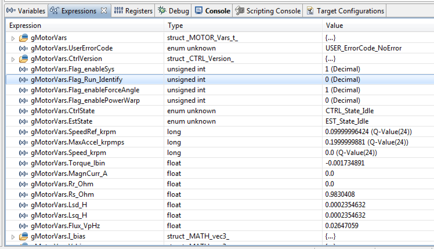

I've worked my way through labs 1-5b and the motor spins decently at high rpm but at 100 rpm there is next to torque and and I can't get it to run below 80 rpm.
So went back to lab2c and to check the fundamentals and they seem a bit off and I'm not sure what to try next.

But this what I get in lab2c
So it looks like resistance is a bit low (measured 0.98 should be 1.2), inductance is way about double of what it should be  high (measure 235 uH should be 120 uH) and the back emf (if I got that right) is about half of what it should be (measures as 26.4 mV/rpm when if my math is correct it should be about 42 mV/rmp).
Is my number of poles wrong or measurement frequency off or what?

    Your parameters look good and R/L and Isc are expected for this motor. It's not particularly low inductance, so I'm curious if 2a also worked?

  • Our parameters are line to neutral, so half of line to line. Also, datasheets typically aren't so accurate. Further, inductance is not a static value. It changes with speed and load.
    Have you tuned your speed controller at all?  Turn OFF ForceAngle and try. You can also run in torque mode and load the motor to near full to test the limits.
    If your motor makes 1 rev per sec with 60 RPM or 2 rev with 120 RPM you have chosen your poles correctly. I would expect this motor to have 2 poles, for 60krpm that is 1khz electrical. Very reasonable.
    And your Bemf will produce just over 20V at that speed, just under the Vbus.

    Your Ls is worrisome.  If your spec is 120uH I would expect to ID around 60uH with InstaSPIN.  345uH is a gross inaccuracy.  Ls is dominant at high speed, but being this far off will cause some low speed issues.
    Why don't you try updating some different values in user.h and bypassing Motor ID: 60uH, 120uH, 180uH
    #define USER_MOTOR_Ls_d                 (0.000060)
    #define USER_MOTOR_Ls_q                 (USER_MOTOR_Ls_d)
    See if performance improves.
    BTW - your datasheet Rs / Ls = 10,000 Hz.  That is really high...but often these motors are designed like that..
    Flux:
    Your 6.67 mV/rad-sec = 0.042 V/Hz, so our value is reasonable.
    BTW - your datasheet short circuit current = 55.6 A, which is reasonable.
    If we reverse solve for the Ls to use based on our ID'd flux and 55.6A it would give you 74uH.
    So I would try
    #define USER_MOTOR_Ls_d                 (0.000074)
    Looking at your issues with not geting enough current, I think having a new lower Ls will increase your bandwidth in the curren controllers, making them react faster. I also recommend setting this higher than the 3A you were using.
    #define USER_MOTOR_MAX_CURRENT          (10.0)
    BTW - are you using proj_lab2c to ID this motor?  You will absoutely have to use 2c based on the R/L and low flux / low Ls.  None of the other projects will work.
    Give that a try...I feel success is close.

    now I've got a good setup with digitally controlled dynamometer, torque sensing and rpm measurement.
    I've gone back to lab5a to see that I can control the current.
    I went with your suggestions and set:
    #define USER_MOTOR_Rs                   (1.019281)
    and now I can get 12 Nmm @ 1 Amp which is in line with this motor spec,
    the rpm is a tad off, gMotorVars.Speed_krpm = 1.0 when the dyno says aprox 950 rmp
    but event though I set qRef_A long = 2.0 I cannot get the motor to use more than 1 Amp,
    I try to brake it some more it will just stall.
    So what is limiting my torque, I would have the PI control would have given me all its got?
    br Kusti
  • considering the SpeedEst and dyno don't quite agree, and you stall (estimator may be losing sync) I'd guess the Ls value took a guess on is not correct.
    Try lowering this to say 40uH (lower Ls is always better than having too high of Ls) and see if the SpeedEst and torque capability improve.
  • Thanks Chris,
    when I tried to lower the inductance I got "gMotorVars.UserErrorCode == USER_ErrorCode_ctrlFreq_Hz_Low"
    so I scaled the resistance down from 1 -> 0.5 but the motor has trouble starting it stutters and I may have to give it a spin to get up to speed, and when it does the current and torque are little bit more than half of what it was with the higher (70uH) inductance and resistance (1 Ohm) values.
    I also tried to keep the resistance at 1 Ohm while lowering the inductance to 40 uH and compensating by increasing
    USER_PWM_FREQ_kHz to 90 but then nothing happens when I try to run the motor, no error, no nothing, I guess I'm way over acceptable CPU usage with that frequency.
    To summarize, so far 1 Ohm 70 uH  at USER_PWM_FREQ_kHz 45 has produced the best performance, at about 1000 rpm the motor starts nicely and  rpm is about what it should be loaded or not, the only issue is that I get less than half of the torque/current from the motor before it stalls when I load it.
    br Kusti
    just to verify the motor spec we measured the motor resistance and inductance and got back about 0.95 Ohms and 60 uH. The inductance value was thus about half what the spec says.
    These values are also very close to what we have put into the user.h as you can see from the above.
    And it performs nice (as explained in my previous post) except I can't get the max current / torque.
    So how do I find out what is limiting the current? Do dig into the code and debug where the control loop hits the ceiling or what?
    Can you also confirm me if the  USER_MOTOR_Ls_d value is the single coil inductance or inductance between (start config) motor wires?
    We measured 120 uH from wire to wire so coil inductance is 60uH and so we put should set
    is that correct?
    br Kusti
