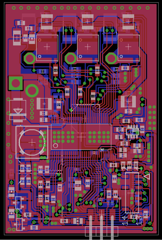

Hi all,
I'm having some trouble with my ESC board and was hoping for some advice -
*Most things are working, JTAG, DC bus voltage feedback, manually checked opamp references / functionality...
The major show stopper at the moment is a complete lack of any sort of PWM from the MCU...
*In troubleshooting this, I have found that en_gate on the gate drive (DRV8301) is sitting at ~1.5V... I know this is not correct but I have yet to trace down the problem.*Is this (1.5V) past the 'on' voltage threshold for the gate driver? It is not in the datasheet (that I can see)... And would this cause the PWM pins on the MCU to be tied to gnd??
-On the PWM pins, I see nothing but noise floating at about 500mV...
THIS IS ALL ON THE MCU SIDE OF THE DRV8301... FETS HAVE YET TO DO ANYTHING (as expected with no PWM).
Looking at the PWM registers, I can see that the outputs should be switching, so I am thinking that they are somehow tied low - I have done continuity tests on them without power and everything checks out.... So, could the lack of PWM be due to the en_gate on DRV8301 not being pushed through 3.3V?
PS - Scope work is slow going (which is why I haven't been able to directly probe the DRV8301) because shorting traces is a real possibility. (Bottom of OP)

    After a day of trouble shooting I now have something more substantive that hopefully someone can help me with. The PWMs are not firing because they are tripped out by TZ2 & 3 caused by a fault reported by DRV8301...Evidently, DRV8301 Fault does not result in a system fault (no ctrl_state_fault is flagged).
    I did find a solder bridge from Fault to Gain/SDO, but clearing it has made no difference at all - maybe it damaged the DRV8301....
    Because OCTW is not reporting a fault, I think there are only a handful of possible causes for the problem;
    I was thinking that this means the fault must be PVDD/DVDD/GVDD/buck under/over voltage.. -I have gone through and checked this and with the exception of GVDD(which is internal) everything checks out....
    I should mention that the fault LED (same setup as BOOSTDRV8301 - PNP transistor) is very dim which made me think that somethings wrong with the hardware... At power up, the Fault pin voltage is 57mV (very dim led) and directly after programming it sits at 3.3V--- led off. *Then when I hit play, its back at 57mV and a very dim LED....
    I can't figure out the 57mV, makes no sense that the voltage floats up a bit unless the DRV8301 is damaged?
    I'm looking into SPI now, but the error doesn't seem to be reported....
    Could someone tell me if my understanding of DRV8301 faults is correct (re Fault low but OCTW high).
  • Hi Patrick,
    If you ENABLE the DRV8301 manually and try to toggle the half bridge manually does the DRV8301 respond?
    Is the DRV8301 responding at all to the SPI request? You mentioned that you checked the values of the regulators and they seemed ok? GVDD is pin that you can check. Pull ENABLE high and report on the values of each regulator.
    What kind of pull up value is on the DRV8301 nFAULT pin?
    One to check is if the PowerPAD has been soldered (you mentioned that you had seen some solder issues). The DRV8301 makes an electrical connection to GND through the PowerPAD.
  • Thanks Nick,
    I bit the bullet and replaced the DRV8301 on my board.... I now have a working custom instaSPIN ESC :)
    80RPM-~6kRPM and about 20% less juice than my 6-step controllers!
    -I'm doing up a board for 'real' fabrication now and was wondering if you think there is an advantage to having the differential signal tracks the same length Going back over a course that covered this, it seems that this is standard practice with differential signals going into a summing amp but I can't see any reason for it on this board (considering DRV8301BOOST) --- wanted to get your thoughts.

    1. Differential sense is a key layout trick to utilize. The amplifiers will be measuring signals in the millivolts and any miss match in line impedence or noise injected into the line will cause errors in the measurements. The "closer" to true differential connections the traces are the better the results. There of course can be some trade offs if you have some room in your measurements. Another key is to keep these traces away from noisy signals when possible.
    2. The FAULT pin is open drain. If the DRV8301 is having issues it's behavoir can be unpredictable.
    3. I highly recommend looking at the BOOSTXL-DRV8301 layout and using it as a reference for your layout. Once you get to higher currents, proper routing and placement will be key.

    A few more questions if you don't mind me not starting a new forum/
    Nick, regarding the differential signals, I have done my best to ensure track lengths are the same - short of adding wiggly lines.
    At most there out by <1mm - this doesn't seem like much to me, but as I have no experience with 'proper' board layout I thought I should get your thoughts before sending gerbers. - Would you be happy with this? -Board is 15A continuous - 0-16V.

    3*5 cm board (smallest I could get without adding >2 layers)... Will be more than happy to release eagle files once I figure out if the layout is any good.
