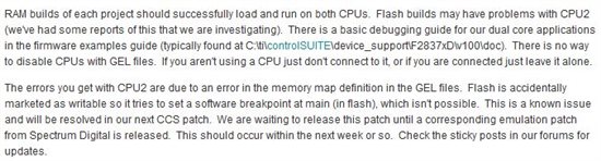

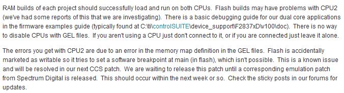

I am trying to run my code on cpu2 on F28377D . I get the following error when I load my program into cpu2 :
C28xx_CPU2: Breakpoint Manager: Retrying with a AET breakpoint
C28xx_CPU2: Trouble Setting Breakpoint with the Action "Finish Auto Run" at 0x841c: (Error -1066 @ 0x841C) Unable to set/clear requested breakpoint. Verify that the breakpoint address is in valid memory. (Emulation package 5.1.402.0)
I have no hardware breakpoints .
Also there is no cpu2 gel file for me . Is it supposed to be there for cpu2 as well ? If so please tell me why it is not being setup .
