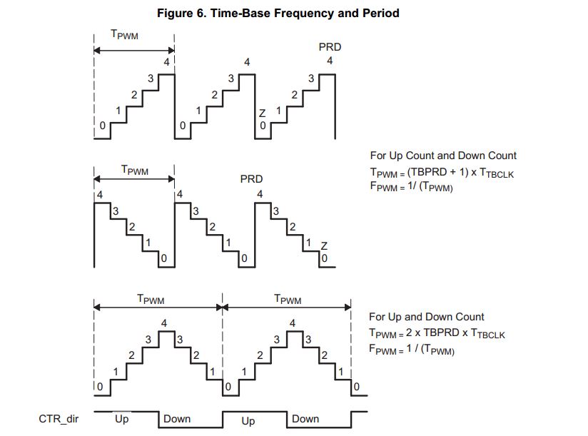

I am using C2000 Launchpad to acquire a waveform through analog channel 1, using EPWM to trigger ADCINT1.
I modified the existing example program adc_temp_sensor. CPU clock frequency is set at 50 MHz. The value loaded into CMPA register is 50 so that I get an ADC sampling rate of 1MHz.
However, the acquired waveform when plotted in the Graph facility available in CCS looks very distorted.
Kindly help with this issue. Thanks in advance. Following is the code:
