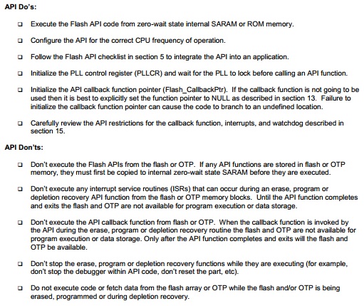

Program one flash sector from another sector.
i want to write code resident in FLASH A sector that re-flash the other sectors.
1. is it possible to program flash sectors from different sector?
2.do i need to erase the wanted sector before the re-flash procedure?
3.the following Is possible ?
Uint32 Data;
Uint32 DestAddr ;
DestAddr  = FLASH_SEC_B_ENTRY_POINT;
 *(Uint32 *)DestAddr  = Data;
welcome any assistance.
Thanks in advance!
