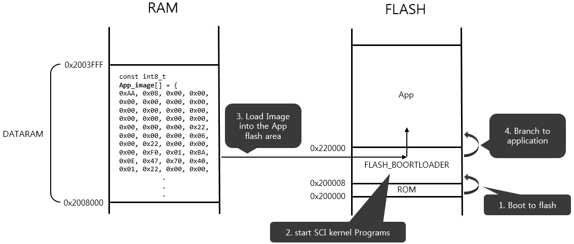

I want to make custom bootloader in specific flash area and jump another flash area which is loaded by bootloader.

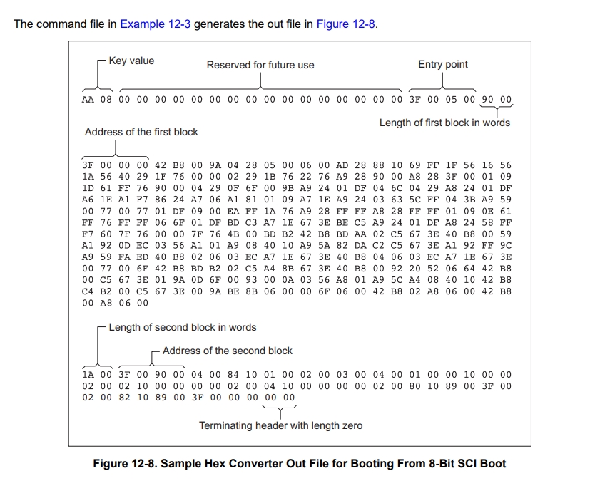

So I have referenced 28379D SCI flash kernel examples in C2000ware and have loaded image into the flash using SCI_boot() function. (Use only the parsing part of the boot image)
I used 2 projects(bootloader,app) here.
The situation currently being tested is as follows.
As far as I understand, CM cannot create SCI boot images. So I experimented like this:
1) In the APP project, I created  .txt file in -GPIO8, -b format - (Success)
2) Convert the txt image to an Array and allocate it into the RAM data section - (Success)
3) Write to Flash by referring to SCI flash kernel program(DFU) - (Failed)
4) Branch and check program operation - (Failed)

I have referenced SPRU513V docs and check data in to the copydata() functions in sci kernel program.
When debugging data in the copydata() function of the sci kernel program, it was confirmed that the key value, reserve value, enry point, length of word, address of the first block are read normally.
I also checked that the values are written to the flash.
However, when I checked the hex value to be parsed, it was confirmed that there was strange destination address in array data.
I am wondering what I did wrong.
Question is,
1. As pictured above, is it correct that I understand the boot loader?
2. How do I convert the CM image and apply it to my kernel program?
3. Is it correct to set .cmd file ?
4. How to excute reset vector?
I really want to know how to update firmware about CM.( Since the program size is large, IPC RAM boot will not be used.)

  • Hi Jude,
    One thing I wanted to clarify - were you able to run the application from Flash using the same hex file that you are showing has strange addresses for the memory blocks?
    In order to stream the application into Flash, I think you will have to make use of the message RAM between CPU1 and CM and transfer the data over in chunks. You will need to develop a protocol that lets CM know when CPU1 has filled the message RAM and lets CPU1 know when CM has emptied the message RAM. You can use IPC flags for this.
    Anu

  • Jude,
    Are you programming the .out file for the application into Flash in the sequence you mentioned above? I believe that should be fine.
    In order to stream the application into Flash, you'll need to develop a protocol as mentioned above where CPU1 uses the message RAM to transfer over the data to CM, and both cores can use IPC flags for communication with each other.
