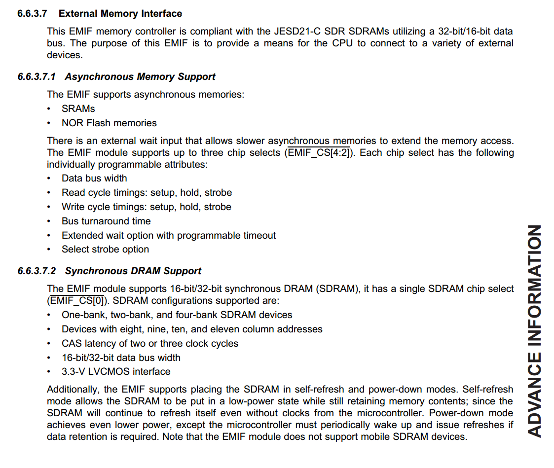

Specifically is there going to be a RAM based device available soon with approximately 150kW code & data area per device (300kW or 600kBytes total)?
Hello Devin,
Thank you for your reply. We already use external RAM on a Flash based F2812, we don't execute from it as access time is slower than internal Flash. I'm unsure if there is a solution where we could use external RAM that is as fast as the internal SARAM.
We are looking for a pure RAM based device to help with development. At the moment we develop in RAM using the emulation environment and build for Flash when the code goes in the product. This changes some details in different parts of our software and we end up testing the code twice (that is the RAM and then the Flash versions). Ideally we will develop in RAM and that will be an accurate representation of when our product is working in the field.
You are correct the C28346 has an adequate amount of RAM for our needs but of course is lacking the dual core power and functionality of the C28377 devices.
Is there anyone who might know what the future dual core developments will be?
