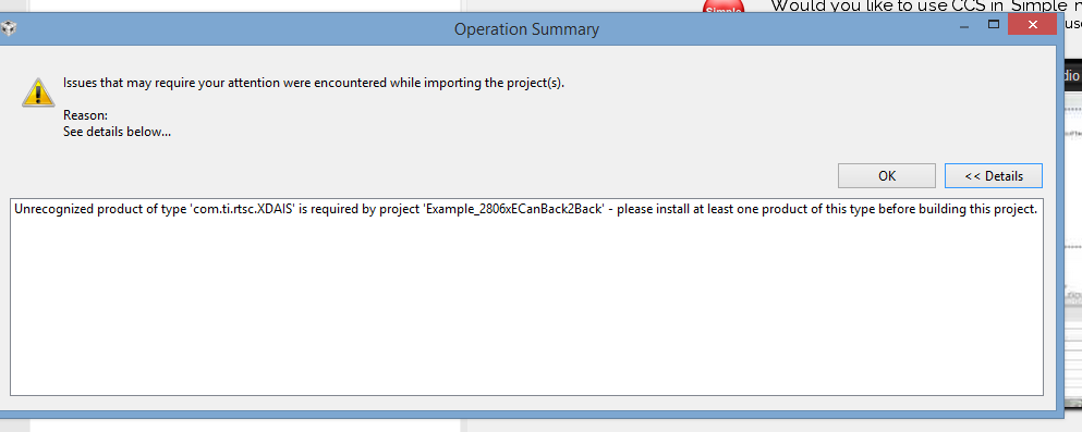

Hello, I am trying to use the eCAN bus of TMS320F28069, for simple send and receive operation. Can someone share a very basic sample code from which I can start?

Which CCS version are you using? Please try updating using "Check for updates" option in Help.
XDAIS component seems to be missing which in turn means that the installation is not done properly. If possible uninstall CCS and install the same with complete feature set.
I believe that I installed it with complete features.Do you think some add-ons are needed because, there are no particular examples for v6.
No, add-ons are not required. Here's the link that can shed some light:
http://e2e.ti.com/support/development_tools/code_composer_studio/f/81/t/241129.aspx
