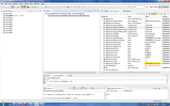

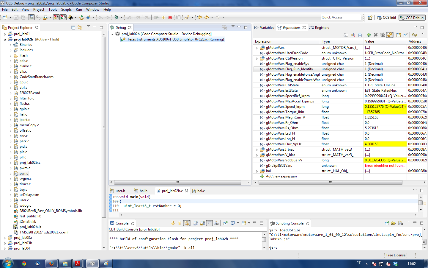

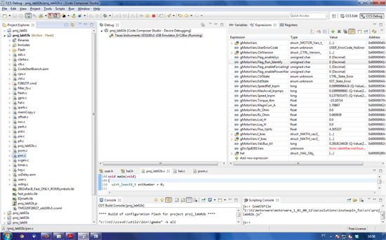

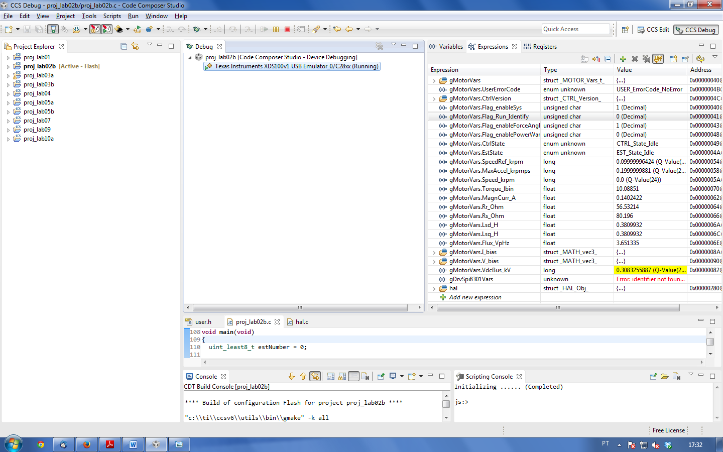

Sorry for bother you with a new post. I'm trying identify a small ACI motor that I have with InstaSPIN 28027F, but I can't finish the identification cause the EST_State return a error few seconds after the gMotorVars.EstState = EST_State_RatedFlux.
And few second after the Error:
I searched for some information about the behavior of motor throughout the identification and I didn't find anything,so I don't know if the motor's behavior it's the right or not fot this situation.
Add my user.h: 0083.user.h
Motor Specs (ABB Motors): (Delta Conf.)
1,9A
0.37 kw
50Hz
I followed the parameters and the design of the HV kit, so I don't know if I configured the user.h parameters correctly. Could you give me some tips if I'm doing some wrongly?

  • Bruno,
    We know that we have some issues with ID on induction motors.
    A couple releases ago we added some additional software logic to correct scaling and keep control during ID for most induction motors.  We knew we still had an issue with ID of the low voltage (<100 Vdc) high current types....but I agree that we also have an issue with some of the "high voltage" (100-350Vdc) induction motors, especially the lower wattage versions.
    I just saw the EXACT same issue as you yesterday at a customer (very embarassing).  We are working on correcting in a formal release, but once we solve I will make sure to update this post directly so that you can ID these motors as well.
  • Could you share a plot of the currents? One thing that didn't look ok was the flux reading while identifying the motor. It shows about 4.3 V/Hz, although the specified rated flux is 0.8165*220.0/50.0 = 3.6 V/Hz.
    Make sure than at the end of the IdRated identification, the flux reading is stable and very close to what you specified under USER_MOTOR_RATED_FLUX. You can adjust how quickly or slowly IdRated is approached to the final value by adjusting this parameter:
    USER_IDRATED_DELTA
    Which has the units of A/trajectory tick. You can convert this value into Amperes per second, or A/s, with this equation:
    USER_IDRATED_DELTA (A/s) = USER_IDRATED_DELTA * USER_IQ_FULL_SCALE_CURRENT_A * USER_TRAJ_FREQ_Hz
    Another thing is if you are using a 27F control card. If you do, make sure you have the correct DIP switches positions, since some of them connect / disconnect analog pins.
    Let me know if this helps.
    -Jorge

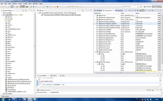

    Yesterday, after I posted this I tried to change some parameters on user.h, like
    USER_IQ_FULL_SCALE_CURRENT_A             (3.0) // 10.00 before
    USER_ADC_FULL_SCALE_CURRENT_A        (5.89)// 19.98 Before
    And with this values I coulded do the identfication. Results:
    I was following the instaspin_labs - lab2a/b for 1st identification of the motor. I coulded do the LockRotor test and get the results, but when I tried to do the next step (pag. 34)
    After I set the flag “gMotorVars.Flag_Run_Identify” = 1, the motor have a erratic behavior during a few time and I dont have any value on the offsets after waiting a lot of time.
    Now I will try the lab3 with the values calculated on lab2 and post here the results. I'll be waiting for your advices about this.

  • This is a custom inverter?
    You can't just change the ADC and IQ values...they need to be accurate to the circuit scaling or else everything will be wrong.

  • if you have a full nameplate you can calculate everything per this post
    http://e2e.ti.com/support/microcontrollers/c2000/f/902/t/318299.aspx
    just looking at the first image you posted I'd say that the magnetizing current identified looks too high (1.8A for a 1.1A motor).
    your flux value is larger that the target you should be setting in user.h
    #define USER_MOTOR_RATED_FLUX           (0.8165*230.0/50.0)

  • Bruno Ramos1 said:
    On the 2nd figure, I already get pass the error and get that values.
    You "got pass the error" by completing changing the Analog to Digital scaling, which gives you incorrect values, even if the motor passes. You've told the SW you are measuring a certain value of 0 to 3.3V at the ADC pin which relates to a real high voltage / high current signal, but your relationship  is now flawed.  These values are not correct (the Rs values look much too high for one thing).
    Please check all of your current and voltage scaling, as well as the voltage filter pole calculations using SPRUHJ1 chapter 5 as a guide.  Update your user.h for your HW. Check the hal.c/.h files that the ADC channels and PWM channels are mapped correctly for your LAUNCHXL-F28027F to your inverter pins.

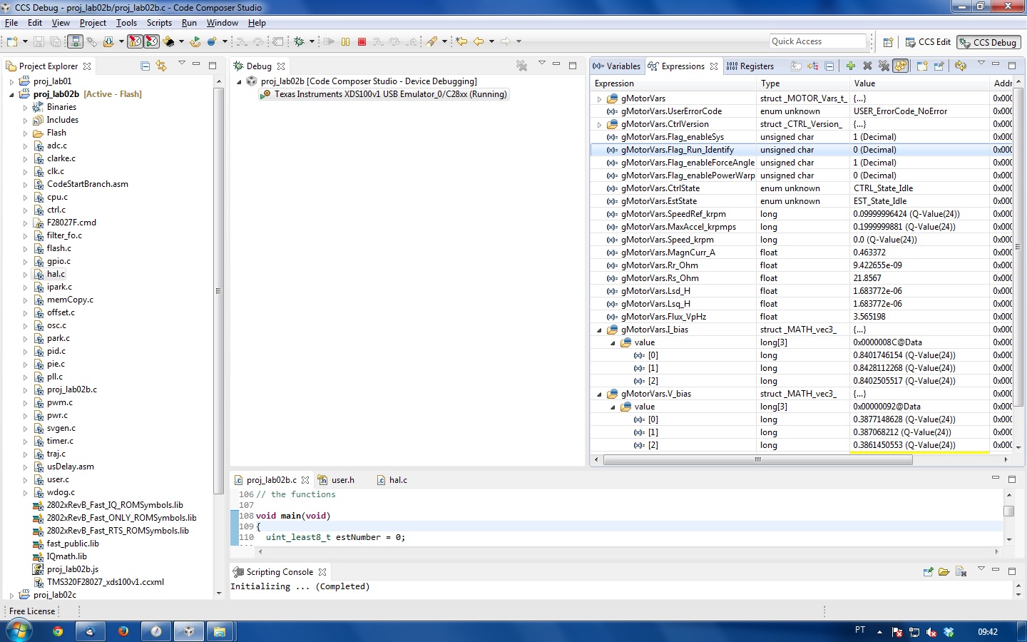

  • Chris,
    I understand your point, and I shouldn't change the scaling values for my HW. Got it.
    I already did what you said and now I have the value of Rs similar the value that I can measure (~= 21 Ohms).
    But the value on Ls_q is too low and return me a error on lab3a/b, and if I increase the Ls_q (I know that I shouldn't, just wanted to see what happens) now return the error that the value of Rr is too low.
    Also, on lab2b after the estimator finishes the motor ID I tried changed the value of "gMotorVars.SpeedRef_krpm" (Try doing what it's on instaspin_labs- lab2a) and nothing happens, the same for “gMotorVars.MaxAccel_krpmps”.
    Could you guide me for what is wrong?

  • For motor ID, when prompted, are you locking the rotor, and keeping the shaft locked for the rest of the ID process?
    The Ls and Rr so small is usually seen if you don't.
    I'd also go back to your original problem.  When ID goes from IdRated to Rated Flux does the rotor keep spinning until RampDown & LockRotor states?
    Assuming your current/voltage ADC/IQ values are correct now, I don't see anything else in user.h that is too concerning. The USER_MOTOR_FLUX_EST_FREQ_Hz at (10.0) is not really required, but typically isn't a problem.
  • Hi Chris,
    Happily, I already could do the ID of the motor without strange behaviors and now I can tune the "gMotorVars.SpeedRef_krpm" & “gMotorVars.MaxAccel_krpmps” flags and see the motor changing his speed.
    The problem: A misunderstanding of the IGBT module! I'm really sorry for bother you and the other people that spend their time with my 'stupid' mistake!Sorry! I hope that you want keep going answering to my questions.
