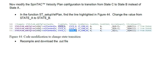

In the lab's 6b Motorware page 147. The lab suggests modifying the velocity plan configuration "STATE A" to "STATE B"
I have found the location in code, changed the state, enabled and all that, but the motor just sits there.
I think (not looking at it right now) the value "gMotorVars.SpinTAC.VelPlanStatus" comes up showing "STATE A" and never changes also.
Would someone please suggest resolutions to my error as well where I might get more information on "STVELPLAN" changes.

    In looking at your code I found the issue.  You cannot have a transition that goes from one state to the same state.  So the line:
    STVELPLAN_addCfgTran(stObj->velPlanHandle, STATE_B,   STATE_B, ST_COND_NC, 0,        0,         _IQ(0.1),      _IQ20(1));    // From StateA to StateB
    configures and invalid transition.
    Also, Plan assumes that you are always starting from the first configured state, which in this case is STATE_A.  So, the way that this plan is setup it would have never left STATE_A since there is not a transition that allows it to leave that state.
    If you change the first transition to be the following, the lab will complete successfully:
    STVELPLAN_addCfgTran(stObj->velPlanHandle, STATE_A,   STATE_B, ST_COND_NC, 0,        0,         _IQ(0.1),      _IQ20(1));    // From StateA to StateB

    However, looking at the screen print attached, I thought it was saying to change the value from STATE_A to STATE_B,
    which would have made it trying to go from B to B.

  • It is, but not every instance of STATE_A should be switched to STATE_B.  It does look like the first STATE_A is highlighted in grey.  Maybe I should update it to indicate highlighted in blue.
  • Adam,
    No argument here. I was just looking at the image and "STATE_A" is highlighted. And one could say that it is highlighted more than the "STATE_A" two lines above. I'm not saying anything is wrong with the instructions.
    It is just how I interpreted them. Don't underestimate the ingenuity of an idiot applies, although I am sure I am not an idiot for seeing it differently than most people.
