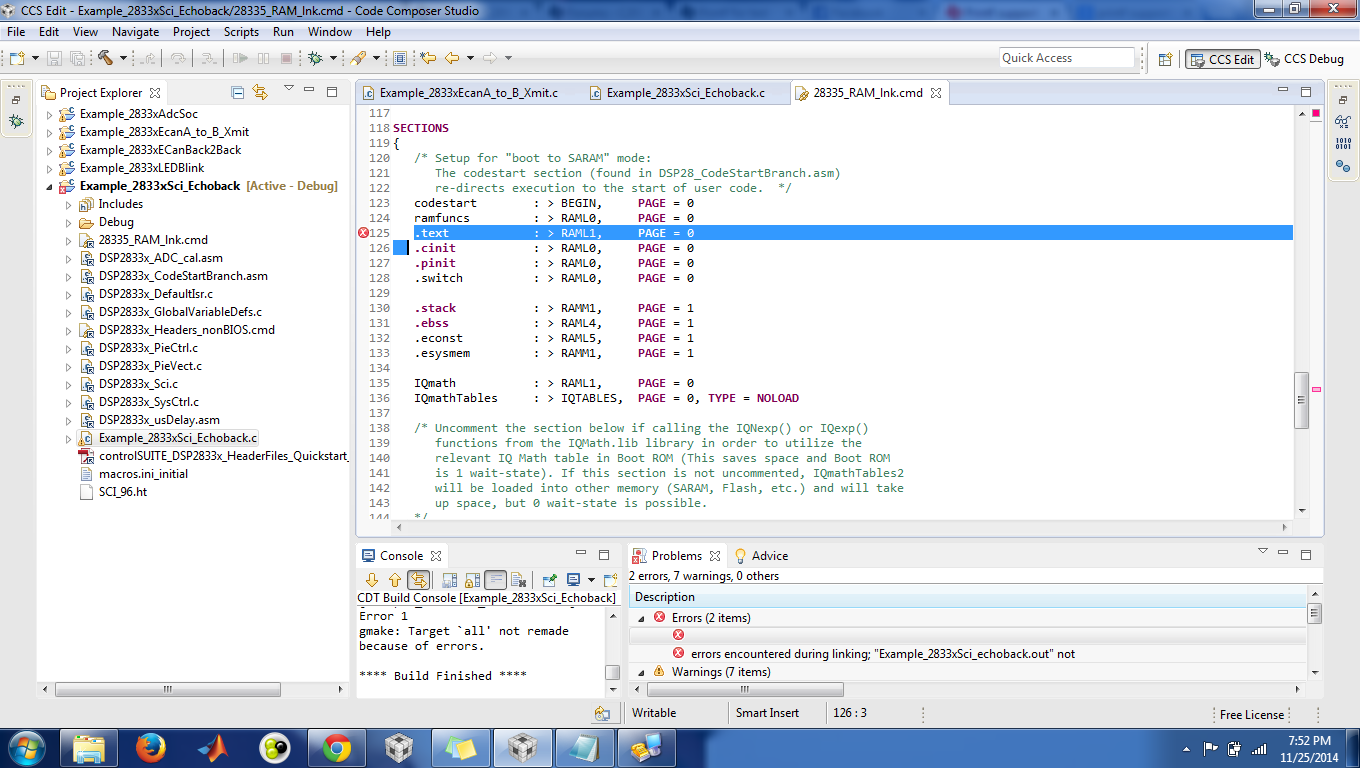

  • Hi
    Any suggestions for handling the above problem.
    I have tried using sprintf command too as given in the article shared above.But to no help.Still the same error exists.
    Is this .text error related to memory allocation and sections allocation.
    Any help would be appreciated.
    Sneha

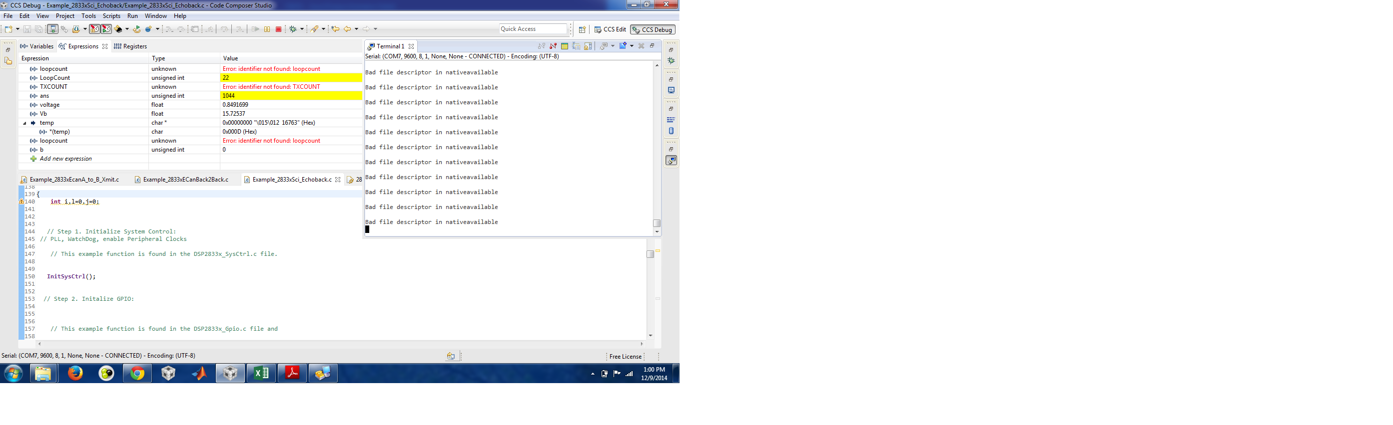

  • Sneha,
    Can you provide more information on the build error you are seeing? It would be helpful to see the console output where the error shows up.
    If you have an open SCI port on F28335 you can connect this to Hyperterminal for the Display portion of your program. I am working on something where I transmit a counter to a terminal program running on my PC.
    I have not actually gotten anything running with Hyperterminal, but I do know that it is possilbe. I have an active setup using TeraTerm, I have used Putty as well. Also, I just discovered today that CCS6 has a terminal program built in and is very easy to use!
    A few pointers I have found to be useful:
    1. Ensure the SCI settings match the terminal program settings
    2. Ensure that the COM port also has the matching settings. (Accessible through the PC Device Manager)
    3. The sprintf() function of <stdio.h> is very useful if you want to view the data on the terminal screen. The code snippet below formats a signed integer (counter) to a character array (temp), which is then sent through scia to my PC. Refer to the C standard library page for <stdio.h> for the details on what sprintf() can actually do.
    This is the output on my terminal (TeraTerm)

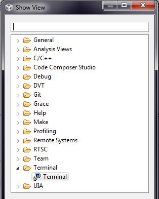

    4. How to get to the CCS terminal:
    View >> Other >> Terminal >> Terminal
    And finally what the CCS terminal window shows. The circle on the left is to open a new connection. The circle on the right is the settings.
    I hope this helps you out!
    -Mark

    The program works fine if I do not use sprintf for displaying data on hyperterminal.With sprintf I get two errors:
    1.Linking error
    2. .text error..
    Please see the screenshot below:
    The hyperterminal settings are as:

  • Sneha,
    The wiki article Gautam had linked to provides some insight into what is going on. The printf() and sprintf() functions are large and require a lot of RAM. If you can show the entire Console output of the Build, it should show that the .text section is not large enough for your program. You can either follow the Wiki and use the --printf_support options to limit the code size, or you can increase the memory allocated for the .text section to fit the whole codesize.
    That is my guess. If you scroll through the CDT Build Console, this error should be traced out and explained fully. Chances are that it will look something like this:
    -Mark
  • Hi Mark/Maria
    Thanks for all your patient support.
    The memory problem has been resolved now.Thanks to the posts at:
    http://e2e.ti.com/support/microcontrollers/c2000/f/171/p/21292/82349.aspx#82349
    But I still can not display a value on the hyperterminal or the CCS terminal the settings seem to correct with correct baudrate,parity and all.following is the screenshot fordebug window while running RX program:

  • Hi Maria
    How do we sortout the memory mapping issue?
    As for temp its not able to map the memory and hence is not able to read.
    For sprintf,I have already increased the RAM allocation in memory for .text.
    Sneha
  • Hi
    After no.of attempts,I am still not able to display the voltage value on CCS terminal/hyperterminal.
    The memory allocation issue was resolved as required for using sprintf.As suggested by Maria I am using following command to get the display:
    sprintf(temp,"\r\n %u",Vb);
    scib_msg(temp);
    where Vb contains the float value (voltage sensed by DSP 0-60 V)
    So I was facing issues with temp: the error being memory map prevent reading x851DBF9F.
    I found no.of threads on the forum and tried implementing the changes..gel file was not included in the code and so I i included it to match the memory  allocation .But of no use.
    Presently somehow after removing the gel file when I run ,now temp takes some random address and comes down to a fixed value ,even that is not displayed.

  • Sneha,
    %u denotes an unsigned decimal integer. since 'Vb' is a float, you might try using the %f specifier.
    Also, I did some searching for the "bad file descriptor in nativeavailable" error in your terminal window, see the last post of this thread:
    http://e2e.ti.com/support/wireless_connectivity/f/968/p/354087/1243471.  You could try a different USB port on your Computer like this person tried.
    Also, are you using the same SCI port for both the ADC comms as well as the terminal? SCI/UART is meant to be point-to-point, i.e. only two devices. You might get into trouble trying to get more than 2 SCIs communicating on the same bus. Try using SCIA for your ADC comms, and then SCIB for your terminal/PC comms.
    Have you ever been able to get even the SCI echoback example working with the Terminal?
    -Mark
