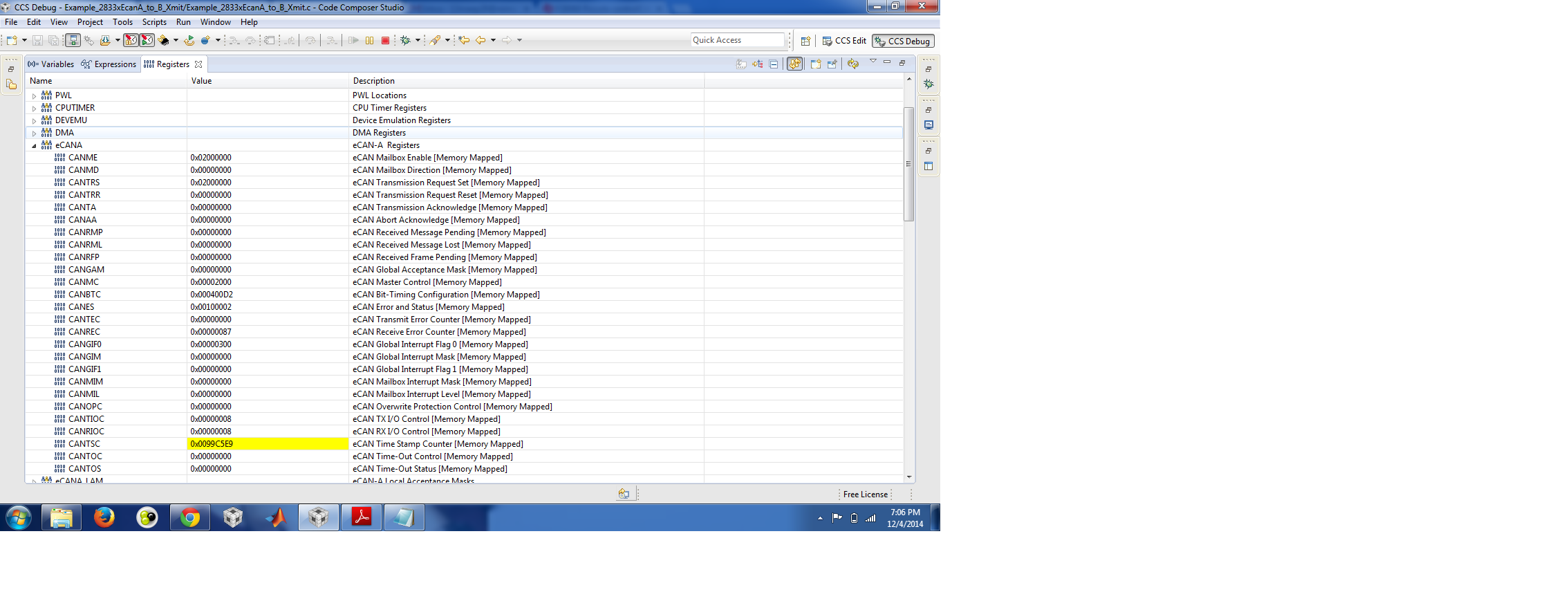

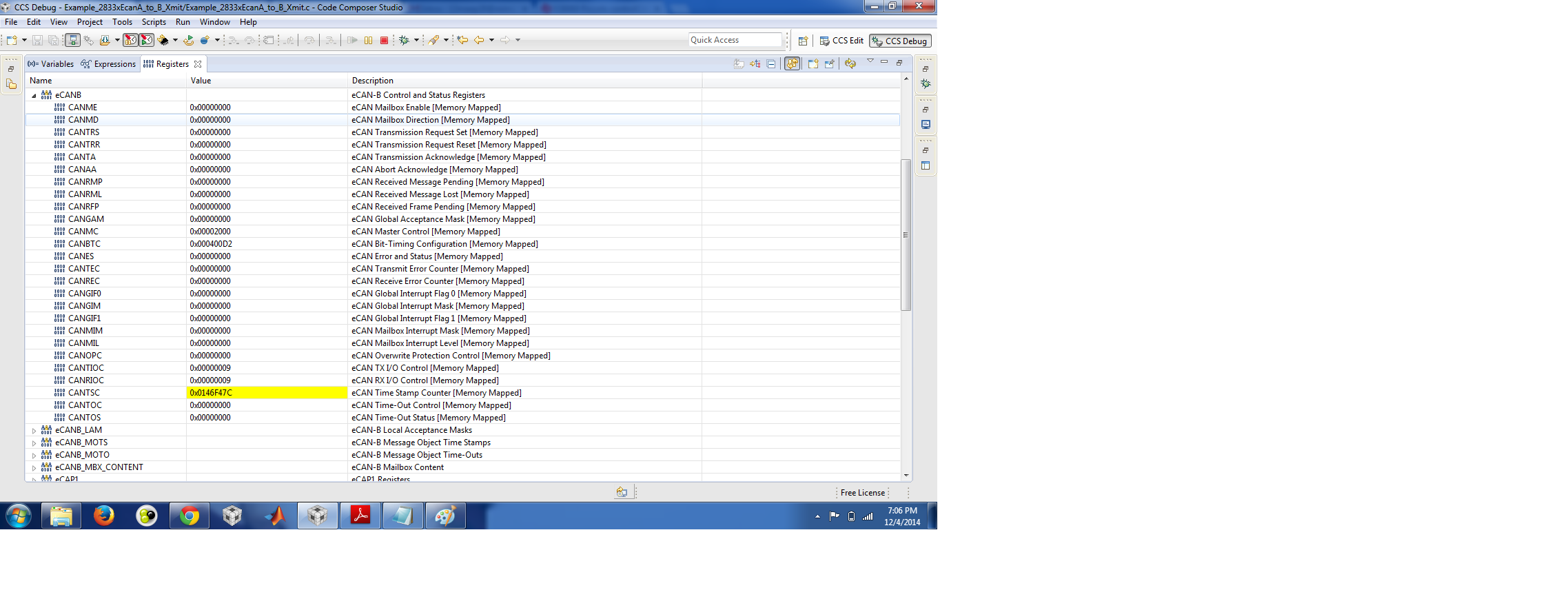

  • Hi Sunil
    Thanks for your patient replies.
    I am working on F28335 and using ISO1050 EVM as CAN transciever,which has on board terminating resistance.SO i need not worry about that.
    The problem am facing is that I am trying to establish communication using CAN by running control suite example program ecan a-b-xmit.But am not getting the expected CANH and CANl waveforms nor do I recieve something.
    I get CANH and CANL waveforms like below:
    Frequency is 2.5 kHZ but they sometime and then are gone.If I terminate program rebuild again,I do not get them till the system is off for certain minimum amount of time and started again.
    When I check the registers sometimes CANES...BE is set and at other times SE is set:
    1. eCANA- TX at one time
    2.eCANb-Tx at other time checked later on
    3. eCANB-Rx
    obviously the transmission is not taking place and I am really stuck at it.Please spare you time to look into this.
    I would really be grateful to you.
    thanks & Regards
    Sneha

  • I have following observations:
    1.   You are using single-ended probe for observing CAN Bus waveforms on CRO.
          CAN Bus functions on differential signalling at physical layer.
          i.e., CAN Bus transceiver detects and interprets (calculates / understands) difference between CAN_H and CAN_L signal levels and decides whether data on CAN Bus is Dominant or Recessive (Logic 1 or Logic 0).
         You may not be able to correctly measure / observe signal voltage levels on CAN Bus (which is differential) using single-ended probe. You should use differential probe for observing / measuring CAN Bus signals correctly on CRO.
    Above argument is also applicable for measuring frequency / bit-rate of CAN data on CRO. Frequency / Bit-Rate of CAN data cannot be measured correctly using single-ended probe on CRO.

  • Hi Sunil
    Thanks for the elaborate answer.
    1. I had earlier tested my CAN transciever for CANH and CANL waveforms with single ended probes on two channels of DSO and I didn't face any issues.
    The voltage level and frequency were correct.Thats why I am using the same now.
    So,if thats the case I will try checking this out.
    2. About the configuration i have gone though it again and again.But chances are always there that I missed out on something.Therefore,Keeping in mind the steps given by you,I will again try looking at the code and the configuration steps.
    3.The test setup:
    CCS V6.0
    Experimenter kit TMS320F28335
    Isolated DSO
    CAN Transceiver ISO1050EVM
    Control suite program- eCAN A to B xmit
    CAN A - GPIO19 = CANTX,GPIO18 = CANRX
    CAN B-GPIO8 = CANTX,GPIO10 =CANRX
    For now,I am trying to check the CANH and CANL waveforms without connecting back to CAN module B which is receiver.
    CAN module A = transmitter,GPIO19 is connected to TXD pin of ISO1050 and then I am trying to check the waveforms for CANH and CANL.Doing this gives me the waveforms I shared before but sometimes,not everytime.
    Even if I connect it to reciever :
    CANA- ISO1050 (1) -ISO1050 (2) -CANB
    I donot observe anything with the can registers.
    4. LAM registers are not programmed in the example program given as to what I have understood they are required in SCC mode of CAN.But here I am using it in normal mode,so they aren't required.
    Please point to where I am wrong.
    And I am looking into the steps mentioned by you.Will let you know my observations But guess TI website is down tomorrow for maintenance.
    Therefore I will try to answer tonight as soon as possible.
    Thanks & Regards
    Sneha

    One more thing,I have tested my hardware setup by giving 100kHz pulses from GPIO 31 to CAN transciever TXD pin and i get correct CANH/CANL waveforms;
    I get this any no of times I try,whether I halt /terminate the program.
    With the same setup, only diff now is I give CAN Tx output to TXD of transciever and I get nothing..a lil glimpse of waveforms which I ma getting is really not noticeable.
    Sneha

    In this If I connect tx-rx full connection I dont observe anything with CAN-B registers.Therefore,I am trying to Observe CANH nCANL waveforms first,to enxure if really there is some data.But I do not get the bus.It comes for sometime,the problem.
    I tried writing the following program for TX and RX in CAN but I did not recieve anything on CAN-2 registers,Nor I got any CAN bus.

  • HI SUnil
    Also,as suggested by you I am running the following loopback program for eCAN  with STM=1for self test mode,which works great...
    but with STM =0 nothing...
