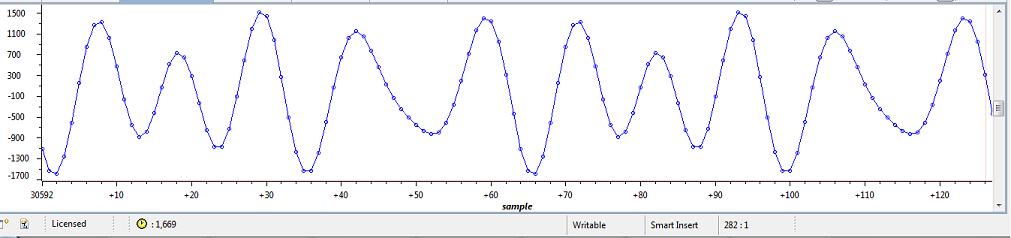

    output:
    how do you see the input and output does not coincide.
    1943 cycles(pack+run+conjugate) for unfinished data, are so many.
    the amplitude is 240 times smaller, does not fit, I expect 4 times smaller and no more.

    output :
    how do you see, 1669 clk for finite data and the amplitude is 4 times smaller,as must be. that a good result.
