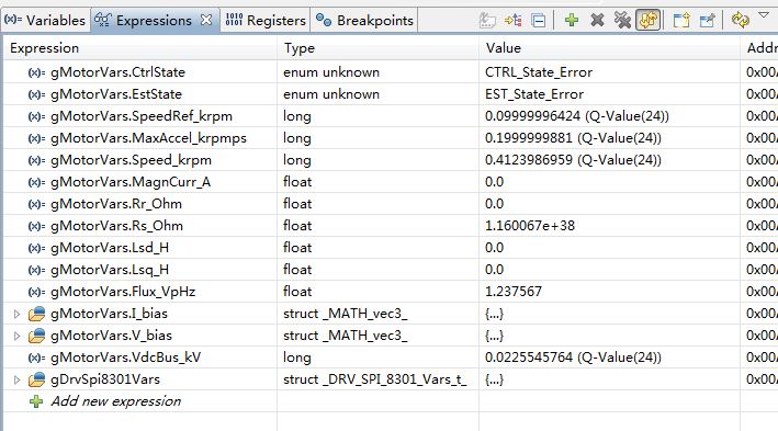

Dear sir/madam,
I used the DRV8301-HC-C2-KIT EVM to spin a servo motor.  It has 8 poles motor, and the motor spec is enclosed. But I always failed to identify the motor in proj_lab02c as attachment shown.
So can you help me configure the user.h to identify the motor?
Qian.Miao
1423.user.h 6710.SmallInertiaServo.pdf
  • #define USER_IQ_FULL_SCALE_VOLTAGE_V (200.0)
    incorrect, set to the bus voltage
    regarding datasheet:
    - is this a high voltage motor? it looks like they are 200-400W at a couple amps rated. That's 100V+ bus. DRV8301 may be able to ID this motor at about 48V bus...but it's not ideal. You should be using TMDSHVMTRINSPIN
    - #define USER_MOTOR_NUM_POLE_PAIRS (2) // this should be (4) for 8 poles
    - this is not a high speed / low inductance motor. You should be able to use proj_lab02a or 02b. You don't need to use 2c (though it should still work)
    main issue is you are trying to ID a High Voltage / Low Current motor with Low Voltage / High Current inverter.

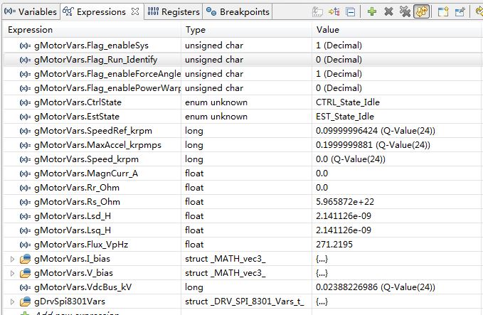

  • Hi ChrisClearman,
      Thank you for reply.
     As you said, I changed USER_MOTOR_NUM_POLE_PAIRS (2)  to (4), and used proj_lab02b. But the kits still failed to identify the motor. Maybe I should used TMDSHVMTRINSPIN
    Qian.Miao
  • Change the IQ_VOLTAGE to the 24V you are using. Notice your Rs is infinite. Looks like a phase isn't connected correctly.
    This isn't the appropriate inverter for this motor though.
