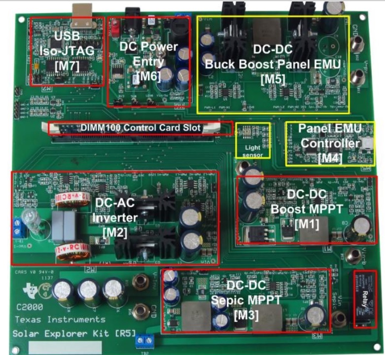

  • Hey guys, I tried to connect board using CCS and it didn't work. I am attaching the image of this board with this thread, can you guys please mark the points where I need to take the voltage measurements from? Thanks .
  • Please see section 3.1 of the user's guide located at
    C:\ti\controlSUITE\development_kits\SolarExplorer\SolarExplorer_PVInverter_F2803x\~Docs
    Can you confirm you confirmed all the jumper settings to be correct? If you are not able to connect through JTAG please ensure
    [Main]-J4 jumper is connected, as that will be the most likely cause of it
