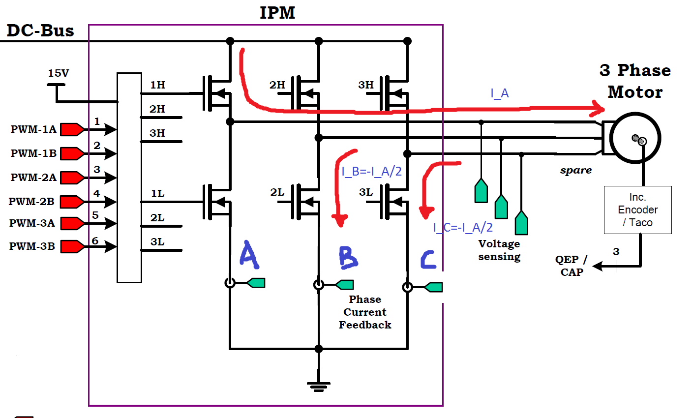

I built my own hardware very similar to the HVkit board. I´m using a LaunchXL F28069M as the main processor. I have something wrong with my current sense circuits. My shunt resistor are OK (or I think so). I chose the same HV Kit´s opamp and the same feedback resistors.When I put the same HV Kit´s values of USER_IQ_FULL_SCALE_CURRENT_A and USER_ADC_FULL_SCALE_CURRENT_A (as it should be as it´s the same circuit) and tried to identify the motor with the lab2B, the real DC current is much lower than the specified in USER_MOTOR_RES_EST_CURRENT.
The measured current offsets are more or less the same as in the HV kit, so i presumed that the amplifiers are functioning correctly. There is some noise added to the current sense output amplifiers so I added a feedback capacitor and I also presume that the software averages the ADC values when measuring the DC current values. As a result of all this, the Rs values are lower than the real values, of course if I diminish IQ_FULL_SCALE and ADC_FULL_SCALE, the Rs values get closer to the real ones but It don´t think that it had any logic to make such a change.
I wonder if the low DC current values and the noise related ti the ADC resolution have anything to do with all this.
Please give a clue.

    I don't understand how the current can be measured in the u phase since it's sourced by the u phase and sinked v, w phase and the shunt resistors only measured the sinked current.

    "I don't understand how the current can be measured in the u phase since it's sourced by the u phase and sinked v, w phase and the shunt resistors only measured the sinked current."
    the shunt resistors measure positive or negative current flow, and all three measurements can be taken at the same time (or consequetivily in our case). under normal sinewave modulation we are only using the current conversion from the U and V phases though. This is handled in the SVGEN functions. During over-modulation logic is used to choose the best 1 or 2 out of 3 currents to use for reconstruction.

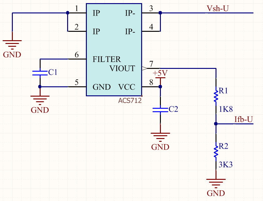

  • I replaced the shunt resistors and opamp with 3 hall allegro sensors (ACS712). I put a current probe in the U phase output.
    I changed USER_IQ_FULL_SCALE_CURRENT_A and USER_ADC_FULL_SCALE_CURRENT_A according with the hall sensor sensibility.
    In the identification of the stator resistance, the real DC current injected in U phase measured with the current probe was 0.6A, but in the hall sensor was 0.3A. Of course the Rs value is wrong.

  • I use +/-20A sensor and my USER_ADC_FULL_SCALE_CURRENT_A    is    (40.0)

    Looking at the datasheet of this sensor, even though it says +/-20A, that doesn't mean -20A to +20A creates 0.0V to 5V. In fact, they have a plot that shows current vs. output voltage, so -20A generates 0.5V, and +20A generates 4.5V. So 4V / 40A = 0.1V/A of sensitivity. If we extrapolate to cover the entire 5V range, this would result in:
    5V / 0.1V = 50A, so +/-25A.
    If we asume a perfect circuit that converts 0 to 5V into 0 to 3.3V, then we would configure user.h with this value:
    USER_ADC_FULL_SCALE_CURRENT_A    is    (50.0)
    Could you try this value?
    If possible please share the circuit you use to convert 5V to 3.3V

    The circuit that I use to convert 5V to 3.3V is a simple voltage divider with 1K8 and 3K3 resistors

  • Thanks. With a 1.8kohm and 3.3kohm resistor divider you get a bit higher than 50. To calculate it we would have this:
    3.3V * (3.3k+1.8k) / 3.3k = 5.1V
    with 100mV/A of sensor sensitivity this would be 51A, so the define should be
    #define USER_ADC_FULL_SCALE_CURRENT_A (51.0)
    Also what is the polarity of the signal comming back from the sensor? In other words, does the output voltage from the sensor increase as the current into the motor increases? or does the voltage increase as the current coming back from the motor increases?
    And do you have three sensors, one per each phase or only 2? If only two, please confirm you are measuring A and B phases and not C, and that you have configured the number of current sensors as 2 if you have 2 sensors:

  • Is it possible to take a look at the schematics showing these sensors? I got a bit confused with your statement: "so my (+) input is connected to GND". Also, what currents do you see on the scope? Is it possible to compare the currents from the sensor vs. the current measured with a current probe?
    -Jorge
  • Hi Jorge,
    the schematic

  • Looking at the sensor datasheet, the specify a minimum output resistance load of 4.7kohm, and you have 5.1kohm. I would recomment the following:
    1. Move the sensor to the motor phase, instead of a direct replacement of a shunt resistor. I think these sensors are not design for PWM switching due to its limited bandwidth (80kHz only). They are design to be in series with the motor winding. So I would short the low side mosfet to ground and place these sensors in series with the motor phases.
    2. Have an output voltage follower, and have the resistor divider on the output of the voltage follower, to have more current source/sink capability and avoid overdriving the output of the sensor
    -Jorge
  • Tu respuesta me lleva a plantear la misma duda inicial. La corriente que sensa el shunt del circuito original NO es la misma que la que va a cada fase del motor(*). Si colocara el sensor en serie con cada fase del motor al tener una lectura de corriente diferente el software no debería funcionar bien.
    (*) Cuando el transistor High conduce, el shunt en serie con el source del transistor Low no sensa esta corriente (que efectivamente circula por la fase del motor), solo se sensa la corriente saliente si se trata de la corriente inducida por la inductancia del motor en el diodo de rueda libre del transistor Low o la corriente entrante de conducción del transistor Low.
    Your answer returns me to the original question. In the original circuit the current sensed by the shunt is not the TOTAL current of each motor phase.It only senses the sinking current when the low transistor is ON and the freewheeling diode sourcing current when the transistor is OFF. Having stated that I imagine that the SAME software cannot behave correctly with different currents.
    Andrés
  • Creo que ya entendi la duda. Cuando el transistor de arriba conduce, tienes razon, en ese instante el shunt no sensa esa corriente, pero la corriente por el shunt no se sensa en ese instante, se sensa cuando el low se prende. Es decir, durante el mismo ciclo de PWM, pero no cuando el de arriba esta prendido, sino cuando el de abajo esta prendido.
    Si se asume ese metodo de sensado de corrient, entonces la corriente que se sensa con un shunt es la misma corriente que se sensa con un sensor en serie con la fase del motor, siempre y cuando se sense mientras el transistor low este encendido.

    los divisores de tensión parecen estar bien, ya que mido con un multimetro la tensión en el puente de diodos y es casi la misma (diferencia de alrededor de 1%) que puedo observar en el debbuger. La tensión de DCBUS es diferente debido a que la tensión de entrada de mi equipo por comodidad es regulable mediante un VariAC  y no siempre pongo exactamente el mismo valor.
    No tengo problema en enviarte los esquemáticos, cabe aclarar que además del capacitor C4 (entre el DCBUS y tierra) que se ve en el pdf hay también en paralelo un capacitor electrolítico de 470uF 450V.

  • Jorge,
    finalmente logré hacer la identificación del motor correctamente!!! Obtengo los mismos valores que obtuve con el HVKit.
    El problema era que yo compré un modulo ya armado para Arduino y éste venía con un capacitor que me estaba seteando el ancho de banda a 8kHz (en la imagen es el C1).
    Al cambiar ese capacitor por uno de 1nF (de acuerdo con la hoja de datos) se solucionó el problema!!
    Gracias por tu ayuda en este aspecto.
