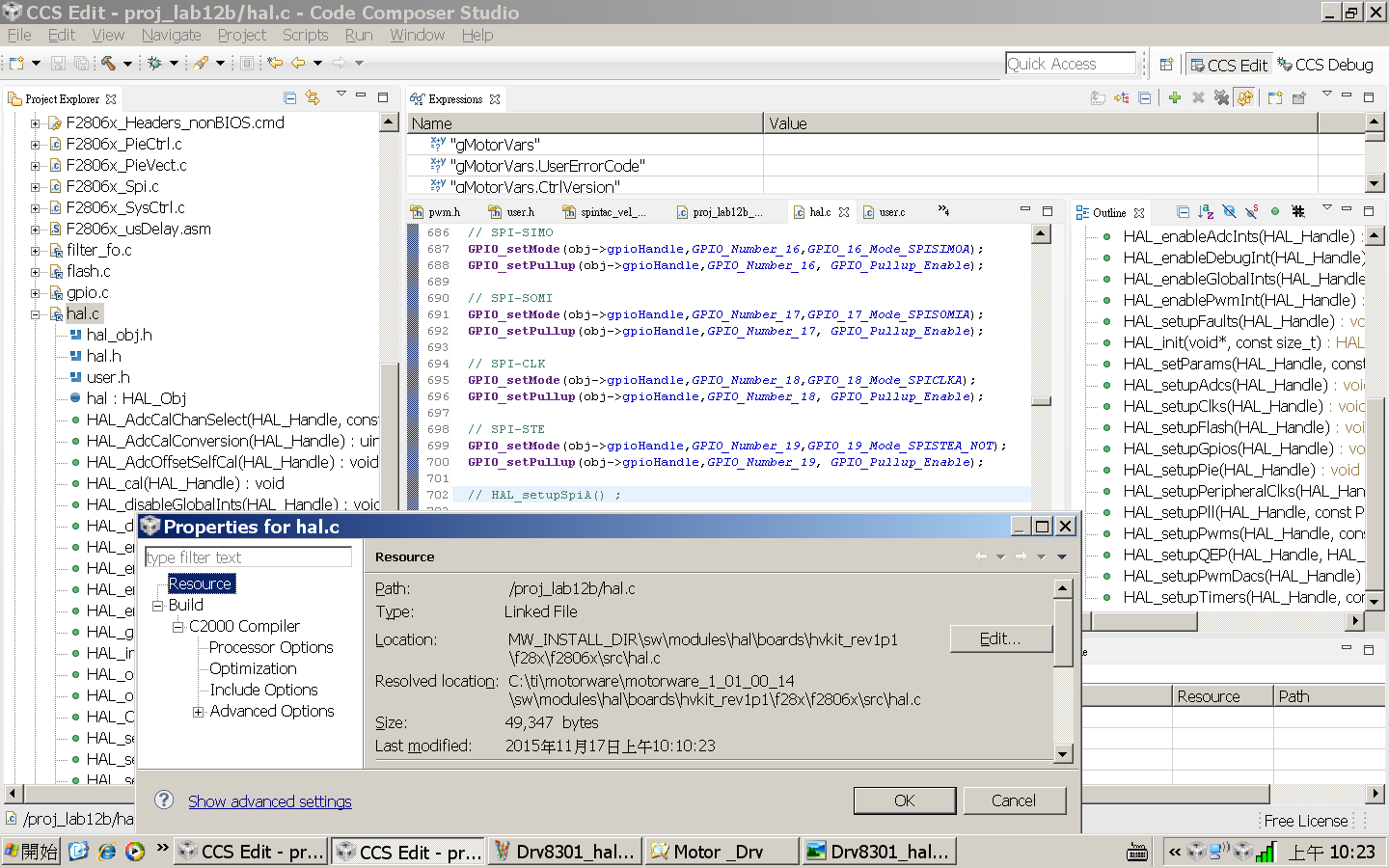

Dear My Friends:
I have a PMSM , resolver kit and Hv-kit with F28069 controller  and I hope to use SPI(slave) to get PMSM postion from resolver Kit(master).I found that there is a SPI-A interface in H2 connector in pin1,3,5 and 7 in the Hv-Kit.I am trying to add SPI(slave) firmware in F28069 of Hv-kit to read rotation postion of PMSM from TI-resolver Kit.Is it possible to implement the function of reading resolver data by SPI ?
Sheng-Hua

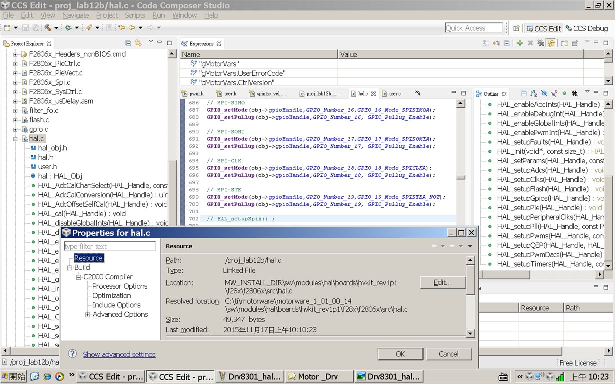

    Yes, you can add SPI-A to your MotorWare project.  The function HAL_setupSpiA() is already available in hal.c, in which it calls functions from SPI.c.    Use this function very much like HAL_setupSpiB() is already used, adding it to HAL_setParams().
    You will also need to configure the GPIO to be for SPI mode.  This is what I am using for the 06x:
    // SPI-SIMO
    GPIO_setMode(obj->gpioHandle,GPIO_Number_16,GPIO_16_Mode_SPISIMOA);
    GPIO_setPullup(obj->gpioHandle,GPIO_Number_16, GPIO_Pullup_Enable);
    // SPI-SOMI
    GPIO_setMode(obj->gpioHandle,GPIO_Number_17,GPIO_17_Mode_SPISOMIA);
    GPIO_setPullup(obj->gpioHandle,GPIO_Number_17, GPIO_Pullup_Enable);
    // SPI-CLK
    GPIO_setMode(obj->gpioHandle,GPIO_Number_18,GPIO_18_Mode_SPICLKA);
    GPIO_setPullup(obj->gpioHandle,GPIO_Number_18, GPIO_Pullup_Enable);
    // SPI-STE
    GPIO_setMode(obj->gpioHandle,GPIO_Number_19,GPIO_19_Mode_SPISTEA_NOT);
    GPIO_setPullup(obj->gpioHandle,GPIO_Number_19, GPIO_Pullup_Enable);
    Here's the function I am using for SPI-A in slave mode.
    void HAL_setupSpiA(HAL_Handle handle)
    HAL_Obj *obj = (HAL_Obj *)handle;
    SPI_reset(obj->spiAHandle);
    SPI_setClkPolarity(obj->spiAHandle,SPI_ClkPolarity_OutputRisingEdge_InputFallingEdge);
    SPI_disableLoopBack(obj->spiAHandle);
    SPI_setCharLength(obj->spiAHandle,SPI_CharLength_16_Bits);
    SPI_setMode(obj->spiAHandle,SPI_Mode_Slave);
    SPI_setClkPhase(obj->spiAHandle,SPI_ClkPhase_Normal);
    SPI_enableTx(obj->spiAHandle);
    SPI_enableChannels(obj->spiAHandle);
    SPI_enableTxFifoEnh(obj->spiAHandle);
    SPI_enableTxFifo(obj->spiAHandle);
    SPI_setTxDelay(obj->spiAHandle,0);
    SPI_clearTxFifoInt(obj->spiAHandle);
    SPI_enableRxFifo(obj->spiAHandle);
    //not needed for slave mode SPI_setBaudRate(obj->spiAHandle,(SPI_BaudRate_e)(0x0003));
    SPI_setSuspend(obj->spiAHandle,SPI_TxSuspend_free);
    SPI_enable(obj->spiAHandle);
    return;
    } // end of HAL_setupSpiA() function
    Don't forget to initialize the SPI-A object in HAL_init():
    // initialize the SPIA handle
    obj->spiAHandle = SPI_init((void *)SPIA_BASE_ADDR,sizeof(SPI_Obj));
    and enable the clock to SPI-A with  CLK_enableSpiaClock(obj->clkHandle) in the functionHAL_setupPeripheralClks().
    Hopefully this helps,
    Jeff

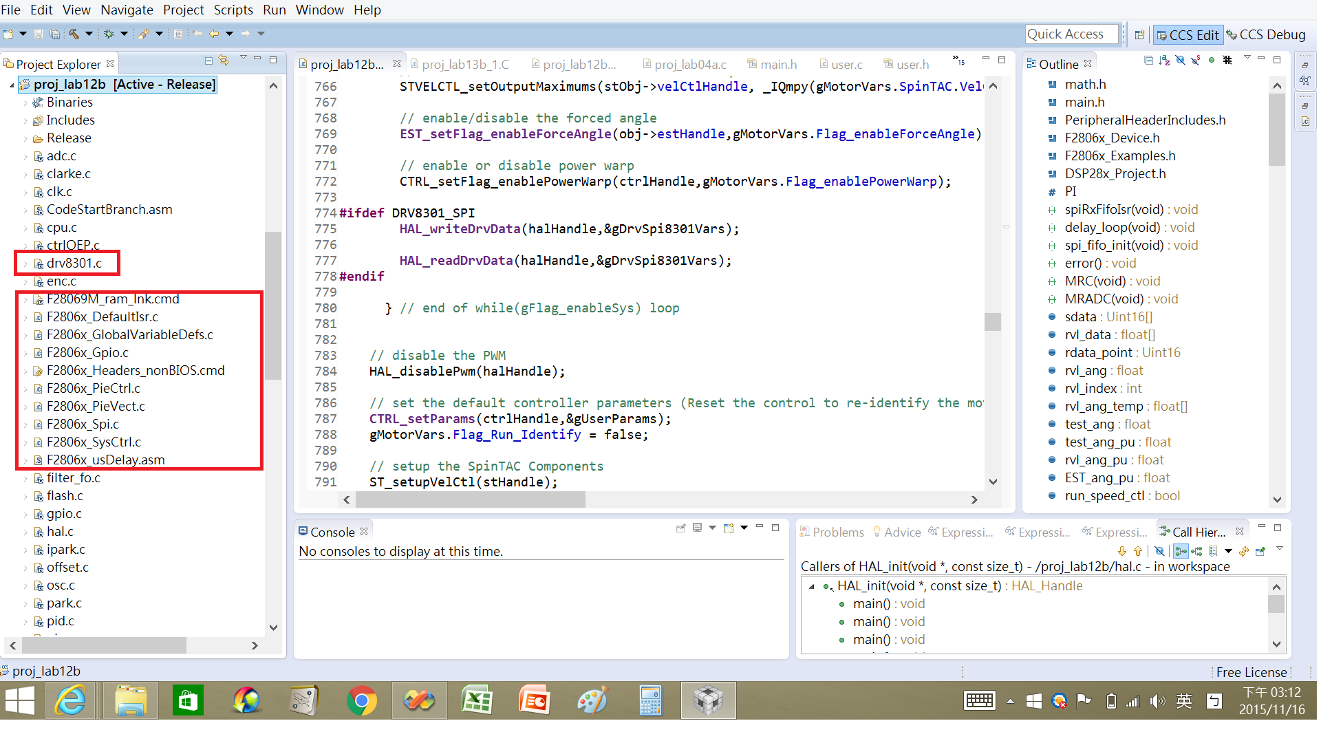

    There is an another issue for SPI read from resolver kit between Drv8301+F28069 and Hv-Kit+F28069.
    I had implemented SPI read code in LAB12b from resolver kit in Drv8301+F28069 and got correct resover data before.Now I am trying to add the code in Hv-Kit+F28069 and found it can't work. (No any interrupt happen for SPI read event)
    It is so intersting. What is different between Hv-Kit and Drv-8301 in Firmware and Hard setting? I found that there is a file of Drv8310.c in Drv-8301 kit.
    Sheng-Hua
    Below is my program code of Lab12b  and some relavent include files in control suit is in the attached file.

    // 2015.0526 by ysh for resolver data .....st .....
       Uint16 i;
    // Step 1. Initialize System Control:
    // PLL, WatchDog, enable Peripheral Clocks
    // This example function is found in the F2806x_SysCtrl.c file.
       //InitSysCtrl();
    // Step 2. Initalize GPIO:
    // This example function is found in the F2806x_Gpio.c file and
    // illustrates how to set the GPIO to it's default state.
    // InitGpio(); // Skipped for this example
    // Setup only the GP I/O only for SPI-A functionality
       //InitSpiaGpio();
       InitSpiA_Gpio();
    // Step 3. Initialize PIE vector table:
    // Disable and clear all CPU interrupts
       //DINT;
       //IER = 0x0000;
       //IFR = 0x0000;
    // Initialize PIE control registers to their default state:
    // This function is found in the F2806x_PieCtrl.c file.
       //InitPieCtrl();
    // Initialize the PIE vector table with pointers to the shell Interrupt
    // Service Routines (ISR).
    // This will populate the entire table, even if the interrupt
    // is not used in this example. This is useful for debug purposes.
    // The shell ISR routines are found in F2806x_DefaultIsr.c.
    // This function is found in F2806x_PieVect.c.
       //InitPieVectTable();
    // Interrupts that are used in this example are re-mapped to
    // ISR functions found within this file.
       EALLOW; // This is needed to write to EALLOW protected registers
       PieVectTable.SPIRXINTA = &spiRxFifoIsr;
       //PieVectTable.SPITXINTA = &spiTxFifoIsr;
       EDIS;   // This is needed to disable write to EALLOW protected registers
    // Step 4. Initialize all the Device Peripherals:
    // This function is found in F2806x_InitPeripherals.c
    // InitPeripherals(); // Not required for this example
       spi_fifo_init();   // Initialize the SPI only
    // Step 5. User specific code, enable interrupts:
    // Initalize the send data buffer
     for(i=0; i<2; i++)
           sdata[i] = i;
       rdata_point = 0;
    // Enable interrupts required for this example
       PieCtrlRegs.PIECTRL.bit.ENPIE = 1;   // Enable the PIE block
       PieCtrlRegs.PIEIER6.bit.INTx1=1;     // Enable PIE Group 6, INT 1
       //PieCtrlRegs.PIEIER6.bit.INTx1=1;     // Enable PIE Group 6, INT 1
       // 2015.0618 by ysh .....disable spi tx mode
       //PieCtrlRegs.PIEIER6.bit.INTx2=1;     // Enable PIE Group 6, INT 2
       //IER=0x20;                          // Enable CPU INT6
       IER= IER | 0x20;                                                      // Enable CPU INT6
       EINT;                               // Enable Global Interrupts
    for(;;)
       // Waiting for enable system flag to be set
       } //end of for loop
    } //end of main() program

  • Dear Jeff:
    I have used motorware with 06x and Hv-Kit in the directory of "C:\TI\motorware\motorware_1_01_00_14\sw\modules\hal\boards\hvkit_rev1p1\f28x\f2806x\src".
    I can't find hal_setupSpiA() in the hal.c on the Hv-kit but I can only find it in the hal.c on the Drv-8301 Kit. (Please reference the following figure files)
    What differnt is there between Hv_kit and Drv8301 in hal.c?  How can I add SPIA interface in Hv-kit+F28069 to communicate with resolver kit?
    hal.c in Drv8301-kit
    hal.c in Hv-kit
    Best Regrds,
    Sheng-Hua
  • Dear Jeff:
    I have used motorware with 06x and Hv-Kit in the directory of "C:\TI\motorware\motorware_1_01_00_14\sw\modules\hal\boards\hvkit_rev1p1\f28x\f2806x\src". I can't find hal_setupSpiA() in the hal.c on the Hv-kit but I can only find it in the hal.c on the Drv-8301 Kit.
    Can I use hal.c in the drv-8301 instead of hal.c in the Hv-kit ?
    Sheng-Hua

  • Hi Sheng-Hua,
    I have done same thing before. I have connected motorware (HV-kit) and resolver to digital conversion kit and then pumped angle to the motorware through SPI connection. Same as in your case, I made resolver to digital conversion kit as the master SPI and the motorware as the slave SPI terminal. But I used lab5a to do that. Anyway what I did was,
    First I changed hal.c and configured gpio pins to SPI,
    // SPI-SIMO
    // SPI-SOMI
    // SPI-CLK
    // SPI-STE
    I added 6 filres externally from control suit to the project as in the image.
    Then called InitSysCtrl(); function above the Spi_config(); function which is mentioned below.
    Then configured SPI in a function and put motorware side in to slave SPI mode. Call this function just above the forever for loop.
    void Spi_config(void){
    SpiaRegs.SPICCR.all = 0x0000;
    SpiaRegs.SPICCR.all =0x000F; // Reset on, rising edge, 16-bit char bits
    // SpiaRegs.SPICTL.all =0x0006; // Enable master mode, normal phase,
    // enable talk, and SPI int disabled.
    SpiaRegs.SPICTL.all =0x0000;
    SpiaRegs.SPICTL.all =0x0002;
    SpibRegs.SPIBRR =0x007F;
    Then captured angle data in mainISR funtion
    Spi_angle_data = SpiaRegs.SPIRXBUF;
    Spi_electrical_angle = Spi_angle_data << 8;  // convert to iq format
    Those are the only changes I have made to work SPI and SPI worked with this. I did not used SPI interrupt for the communication. But it worked smoothly.
    Hope this will be helpful to you.
    Thanks.
