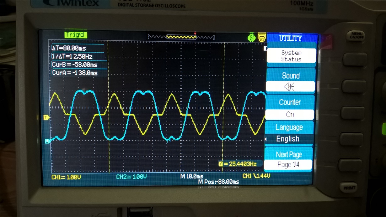

    I just updated three files to make this work on a DRV8312 kit with 6x device running lab 3a. Find the files attached:

    The result that I got is:
    Have you checked and the result is OK? In my opinion, the input of DacData is in _IQ15 format rather than _IQ, because the PWMDAC_setup() ends of the code lines:

  • Dear Jorge,
    Thank your for your reply. However, when I run your HAL_writeDacData() in my project, the DSP be constantly reset!!! While with the sample code are not.
    Beside I looked deeply at the sample code of Lab11 Motorware, the HAL_writeDacData() function is written as:

    I have fixed the problem with my own board when calling your HAL_writeDacData(). The reason is one of PWM pin on my board is toughed to GND, when I fixed this hardware error, the DSP is no longer reset anymore.
    But when I check the shape of Ta, Tb and Tc which is generated by
    SVGEN_run(svgenHandle,&Vab_pu,&(gPwmData.Tabc));
    then I got the strange result on my Oscilloscope, as following:
    This is the imagine of Ta & Tc when write to PWMDAC:
    Did you get the same result?
    Thank you for your feedback!

  • Hi Jorge,
    Thank you for your reply. I followed your way to debug my project, and this it the code section in the main_ISR() in which the HAL_writeDacData() is called:
    //! mainISR() function
    interrupt void mainISR(void)
    	// Declaration of local variables
    	_iq 		angle_pu;					//The angle of space vector
    	MATH_vec2 	Vab_pu;
    	MATH_vec2 	phasor;
    	uint32_t 	timer1Cnt;

    And this is the result of the above code:
    a) (Ta & Tc) or (Tb & Tc) (gDacData.value[0] vs gDacData.value[2]) - This is a wrong result.
    b) gDacdatavalue[2] and gDacData.value[3] - This is a true result!
    But when I write to gDacData.value[0], gDacData.value[1] and gDacData.value[2] with the same data, as the following code:
      dacValue_1 = gPwmData.Tabc.value[0];
      dacValue_2 = gPwmData.Tabc.value[1];
      dacValue_3 = gPwmData.Tabc.value[2];
      dacValue_4 = (_iq)((gPwmData.Tabc.value[0] - gPwmData.Tabc.value[1])>>1);	//Dividing by 2 to nominalize the output signal
      // write to the PWM compare registers, and then we are done!
      HAL_writePwmData(halHandle,&gPwmData);
    #ifdef DEBUG
      //    Connect inputs of the PWMDAC module
    /*  gDacData.value[0] = gPwmData.Tabc.value[1];
      gDacData.value[1] = gPwmData.Tabc.value[2];
      gDacData.value[2] = gPwmData.Tabc.value[2];
      gDacData.value[3] = angle_pu;*/
      gDacData.value[0] = dacValue_1;  // The same value for two remaining channels.
      gDacData.value[1] = dacValue_1;
      gDacData.value[2] = dacValue_1;
      gDacData.value[3] = dacValue_4;
      // write the data to DAC module
      HAL_writeDacData(halHandle, &gDacData);
      //HAL_writeDacData_Jorge(halHandle, &gDacData);
    #endif // DEBUG
    ... and the result is true for all three channels! It's amazing. The result is:
    So that I am in two minds that there are the corruption of gDacData or the HAL_writeDacData() function make the gDacData is corrupted!
    I can send the code for your test with your own kit at
    Notice that you should copy it to the following path:  C:\ti\motorware\motorware_1_01_00_15\sw\solutions\instaspin_foc\boards\vfdkit_rev1\f28x\f2805xF\projects\ccs5\proj_vfd01a
    proj_vfd01a.rar

    #ifdef DEBUG
      //! \notes: Testing result is OK when gDacData.value[0] = gDacData.value[1].
      //! \notes: In case of gDacData.value[0] <> gDacData.value[1], the result is wrong!!!
      //! \notes: Up to now I have not understood why???
      gDacData.value[2] = dacValue_3;

    I am looking forward to hearing from you soon.
    With kind regards,
    Tran
    In hal.c, let's remove the third count, since this is initialized to NULL, I am affraid this code is writing to uninitialized memory or even some registers unintentionally:
    void HAL_setupPwmDacs(HAL_Handle handle)
      HAL_Obj *obj = (HAL_Obj *)handle;
      uint16_t halfPeriod_cycles = 512;       // 3000->10kHz, 1500->20kHz, 1000-> 30kHz, 500->60kHz
      uint_least8_t    cnt;
      for(cnt=0;cnt<2;cnt++)
    Let's also comment this out at the end of the function
      //PWMDAC_setPeriod(obj->pwmDacHandle[PWMDAC_Number_3],halfPeriod_cycles);
      return;
    }  // end of HAL_setupPwmDacs() function
    Could you also send me hal.h file? I want to double check the implementation of function: HAL_writeDacData
    -Jorge

  • I don't find anything wrong. By the way, I think this function is a bit more compact and easier to debug when it comes to writing DAC values:
    static inline void HAL_writeDacData(HAL_Handle handle,HAL_DacData_t *pDacData)
      PWM_Obj *pwm = (PWM_Obj *)obj->pwmDacHandle[PWMDAC_Number_1];
      _iq period = (_iq)pwm->TBPRD;
      _iq pwmData_sat, pwmData_sat_dc, value;
      uint16_t value_sat[4];
      uint_least8_t cnt;
      for(cnt=0;cnt<4;cnt++)
          pwmData_sat = _IQsat(pDacData->value[cnt],_IQ(0.5),_IQ(-0.5));
          pwmData_sat_dc = pwmData_sat + _IQ(0.5);
          value = _IQmpy(pwmData_sat_dc, period);
          value_sat[cnt] = (uint16_t)_IQsat(value, period, _IQ(0.0));
      // write the DAC data
      PWMDAC_write_CmpA(obj->pwmDacHandle[PWMDAC_Number_1],value_sat[0]);
      PWMDAC_write_CmpB(obj->pwmDacHandle[PWMDAC_Number_1],value_sat[1]);
      PWMDAC_write_CmpA(obj->pwmDacHandle[PWMDAC_Number_2],value_sat[2]);
      PWMDAC_write_CmpB(obj->pwmDacHandle[PWMDAC_Number_2],value_sat[3]);
      return;
    } // end of HAL_writeDacData() function
    Can you please use that function? and let's write a known value to all four DACs so we can focus on the one(s) with the problem.
    -Jorge
  • Hi Jorge,
    That's a good idea, your compact function to implement HAL_writeDacData(). I tried and verify that it worked well.
    For my problem, I have just found that there is a hardware error in my mainboard where I plug my controlCARD on it. When I fixed this mistake the results on Dac outputs are true.
