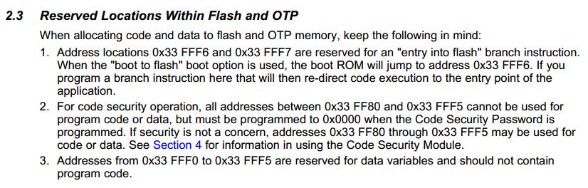

In the 2KB of OTP ROM used in the TMS320F28335, there is a reserved space for the ADC calibration routine ADC_cal()
There are other reserved memory space by TI in the OTP ROM?
Sincerly,
ben
ok thanks for your answer.
1) However in the paragraph 2.3 Reserved within Flash and OTP" we don't talk about the OTP because all address locations are mapped to Flash memory address (0x30 to 0x33 FFFF), is correct ?
2) In the datasheet in the memory map figure 3-2, I can see the 2KB of user OTP memory (address 0x38 0400 - 0x38 0800), so we well have 2KB of OTP for user?
Sincerely,
