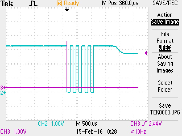

I am using a custom board using 28027F. I am using Motorware Lab 20 for my project. The board uses RS-485 for SCI communications. The isolator's transmit and received enable pins are shorted. I have set up the communications but I need to toggle the enable pins so as to receive and transmit. I can set the GPIO12 high and low to transmit however it does not toggle. If it is set high (or low) at the beginning (in hal.c) file it retains that value throughout the program. I want to keep it low so that I will always receive communication, set it high only when I am going to transmit. This is the short code I wrote to test it:
In main.c
ReceivedChar = HAL_sciaRead(halHandle);// & 0x00FF;
if(receiveflag==1)
//HAL_pieAckInt(halHandle,PIE_GroupNumber_9); // Issue PIE ack INT9
GPIO_setHigh(gpioHandle, GPIO_Number_12);
HAL_sciaWrite(halHandle, 5);
GPIO_setLow(gpioHandle, GPIO_Number_12);
//receiveflag = 0;
in hal.c in setupGpio function
// RS-485
GPIO_setMode(obj->gpioHandle,GPIO_Number_12,GPIO_12_Mode_GeneralPurpose);
GPIO_setDirection(obj->gpioHandle,GPIO_Number_12,GPIO_Direction_Output);
GPIO_setLow(obj->gpioHandle, GPIO_Number_12);
The pin seems to remain low instead of going high in the if loop.

Peter,
I ran that part of code in single steps and monitored the output of GPIO 12 on the CRO. I found out that the code itself is working. As in the pin goes high, then it executes the HAL_sciaWrite function and then the pin goes low again. However when I run the code continuously, I just see a spike on the CRO. The pin goes high momentarily and becomes low again even before the HAL_sciaWrite function writes the data on Tx pin. So even though I get transmission at the output of the processor, nothing gets transmitted from the board.
Does the sequence of operations change between running continuously and going step by step?
The purple is the output of GPIO 12 and blue is Tx.
