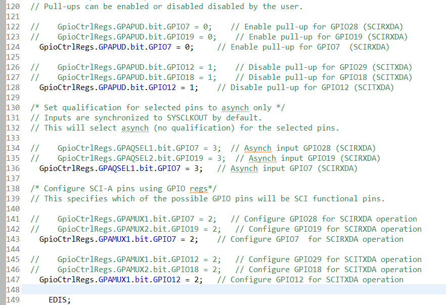

       EALLOW;
      /* Enable internal pull-up for the selected pins */
      /* Disable internal pull-up for the selected output pins
         to reduce power consumption. */
      // Pull-ups can be enabled or disabled disabled by the user.
      //	GpioCtrlRegs.GPAPUD.bit.GPIO7 = 0;    // Enable pull-up for GPIO28 (SCIRXDA)
      //	GpioCtrlRegs.GPAPUD.bit.GPIO19 = 0;    // Enable pull-up for GPIO19 (SCIRXDA)
      	GpioCtrlRegs.GPAPUD.bit.GPIO7 = 0;     // Enable pull-up for GPIO7  (SCIRXDA)
      //	GpioCtrlRegs.GPAPUD.bit.GPIO12 = 1;	   // Disable pull-up for GPIO29 (SCITXDA)
      //	GpioCtrlRegs.GPAPUD.bit.GPIO18 = 1;	   // Disable pull-up for GPIO18 (SCITXDA)
      	GpioCtrlRegs.GPAPUD.bit.GPIO12 = 1;	   // Disable pull-up for GPIO12 (SCITXDA)
      /* Set qualification for selected pins to asynch only */
      // Inputs are synchronized to SYSCLKOUT by default.
      // This will select asynch (no qualification) for the selected pins.
      //	GpioCtrlRegs.GPAQSEL1.bit.GPIO7 = 3;  // Asynch input GPIO28 (SCIRXDA)
      //	GpioCtrlRegs.GPAQSEL2.bit.GPIO19 = 3;  // Asynch input GPIO19 (SCIRXDA)
      	GpioCtrlRegs.GPAQSEL1.bit.GPIO7 = 3;   // Asynch input GPIO7 (SCIRXDA)
      /* Configure SCI-A pins using GPIO regs*/
      // This specifies which of the possible GPIO pins will be SCI functional pins.
      //	GpioCtrlRegs.GPAMUX1.bit.GPIO7 = 2;   // Configure GPIO28 for SCIRXDA operation
      //	GpioCtrlRegs.GPAMUX2.bit.GPIO19 = 2;   // Configure GPIO19 for SCIRXDA operation
      	GpioCtrlRegs.GPAMUX1.bit.GPIO7 = 2;    // Configure GPIO7  for SCIRXDA operation
      //	GpioCtrlRegs.GPAMUX1.bit.GPIO12 = 2;   // Configure GPIO29 for SCITXDA operation
      //	GpioCtrlRegs.GPAMUX2.bit.GPIO18 = 2;   // Configure GPIO18 for SCITXDA operation
      	GpioCtrlRegs.GPAMUX1.bit.GPIO12 = 2;   // Configure GPIO12 for SCITXDA operation
          EDIS;

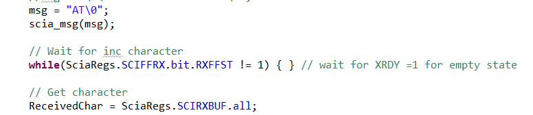

        for(;;)
           msg = "AT\0"; // Command that asks for info about the bluetooth.
           scia_msg(msg);
           // Wait for inc character
           while(SciaRegs.SCIFFRX.bit.RXFFST != 1) { } // wait for XRDY =1 for empty state
           // Get character
           ReceivedChar = SciaRegs.SCIRXBUF.all; // I still have to make a function to receive a whole "sentence" instead of only one char
           DELAY_US(2000000);
           msg = "AT+NAME\0"; // Command that sets for bluetooth name.
           scia_msg(msg);
           scia_msg("ZUERA\0"); // Set bluetooth name as ZUERA
           ReceivedChar = SciaRegs.SCIRXBUF.all; // Bluetooth replies with the name set
           DELAY_US(2000000);

    Sorry that I missed your updated post. GPIO config seems fine but on the hardware side, is your bluetooth module interfaced with TTL or RS-232 logic?
    Also, nothing will get displayed on the PC as these GPIOs need to be converted to proper level.

  • Unfortunately the bluetooth module (HC-06) has a very poor datasheet. The only information I could find was in its name: It's called "HC-06 RS232 TTL module". So I cannot say for sure. I am still trying to find out for sure, but I'd say it is RS232.
    Although, with the code above, I noticed that *sometimes* it partially works. By that I mean I can sometimes set the bluetooth name and it would actually change. And when it changes, it misses some characters or get them wrong.
    For example, when I changed the name of it to "Testing this", and checked it on my android, the bluetooth network available was: "Te◘¶ing thᶲ◘"
    Could this be a baudrate problem??
    The bluetooth device is at a 9600 BR (default) and in the code the if statement in (CPU_FRQ_60MHZ) sets the communication to that BR too. If it is a BR problem then maybe the bluetooth device isn't at 9600 (even though it comes as default).
