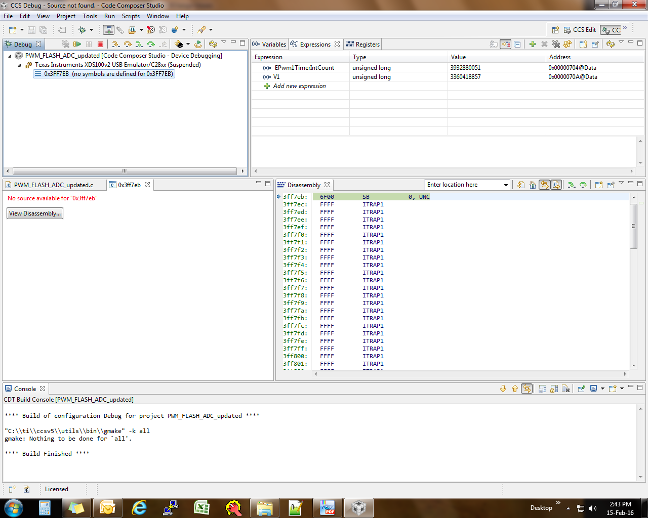

    According to the screenshot (call stack) your problem might be related to the InitAdc function. Could you please try to comment out that as well, and also the part of the ConfigADC that deals with the ADC.
    BR,
    Janos
  • Hello Aditya,
    Thank you for your suggestions.
    Tried it but not giving a useful result. Attaching a screen shot.
    Though I found one code by Gautam, on one of the threads which integrates ADC and EPWM, trying to understand it..hopw it will work in my system.

    Without ADC code it is working perfactly. When I insert ADC code the program goes into Illigal_ISR.
  • Hi Anup,
    Also you can refer example code from controlSUIT
    ..\ti\controlSUITE\device_support\f2802x\v230\f2802x_examples_drivers\adc_soc
    In this example, pwm is used to trigger ADC SOC
    regards
    Aditya
  • Hello Anup,
    You might try to insert the ConfigADC(); call before enabling interrupts. I am not sure that this will help, it just looks more clean to me to do all initialization before enabling interrupts.
    Janos
  • Hi Anup,
    For your code, Add EALLOW for pwm configuration and check. Just a try.
    EALLOW;
      EPwm2Regs.ETSEL.bit.SOCAEN = 1; // Enable SOC on A group
      EPwm2Regs.ETSEL.bit.SOCASEL = 4; // Select SOC from from CPMA on up count
      EPwm2Regs.ETPS.bit.SOCAPRD = 1; // Generate pulse on 1st event
      EPwm2Regs.CMPA.half.CMPA    = duty_cycle; // Set compare A value
      EPwm2Regs.TBPRD = period; // Set period for ePWM1
      EPwm2Regs.TBCTL.bit.CTRMODE = 0; // count up and start
    EDIS;
    Aditya
