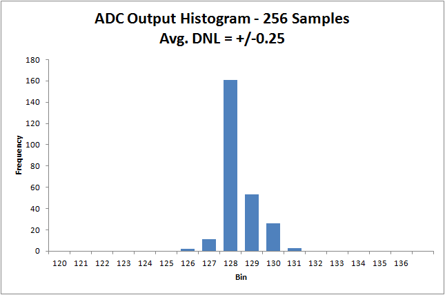

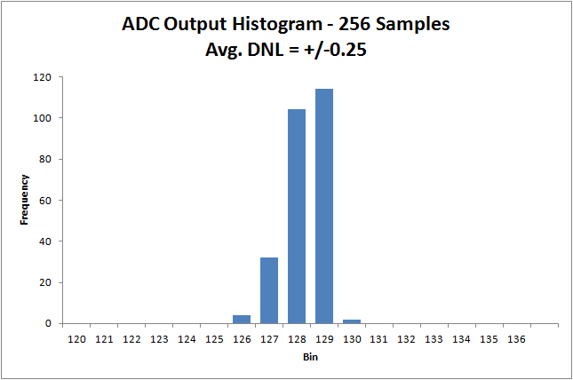

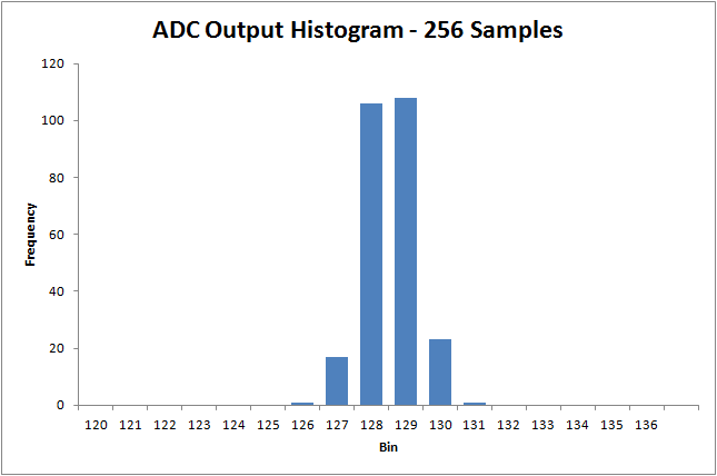

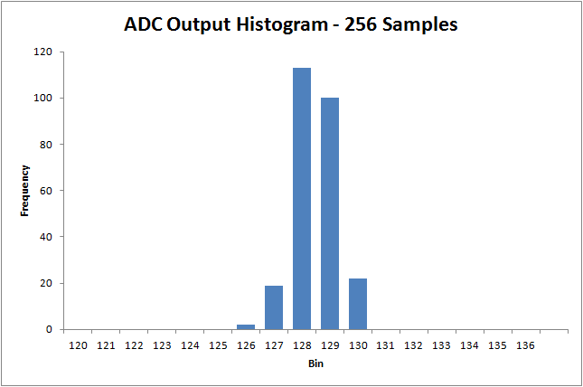

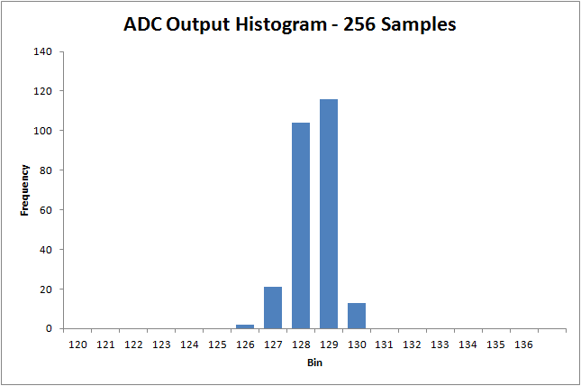

    Interestingly, even with a Gaussian noise source on the input, the output may not look quite Gaussian due to the DNL of the ADC.  Here are 3 simulated graphs with randomly generated Gaussian noise with center code = 128, noise STDEV = 0.7, and no DNL errors - these look pretty Gaussian:
    However, when we add some simulated random DNL errors, the graphs may looks quite a bit less Gaussian, even though the input noise is in fact Gaussian:
    (Note that the DNL in this case is the average DNL, not the Min/Max DNL...these distortions wouldn't occur throughout the whole transfer function for a normal ADC, only at some worst case spots)
    All of this is to say that I don't think a snapshot of the input histogram is all that useful; you are much better off working with the SNR, as this captures the noise across the full ADC range.
