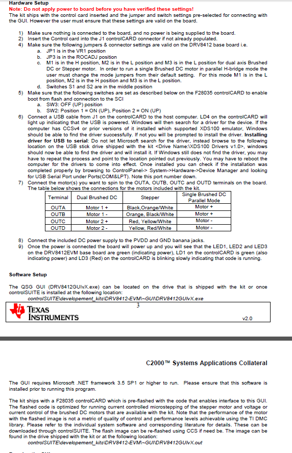

I am using a DRV8412 C2 Kit Motor board, and a Controlcard that has a C2000 (F28035) Piccolo MCU. I am having problems with connecting to target.
Error Below :
Error connecting to the target:
(Error -1135 @ 0x0)
The debug probe reported an error. Confirm debug probe configuration and connections, reset the debug probe, and retry the operation.
(Emulation package 6.0.14.5)
Console Error:
C28xx: Error connecting to the target: (Error -1135 @ 0x0) The debug probe reported an error. Confirm debug probe configuration and connections, reset the debug probe, and retry the operation. (Emulation package 6.0.14.5)
When I go to Test connection. the .ccxml file error pasted below:

I don't know how to fix this. I tried both V1 USB and V2, without connecting to the target, I can't run any code for Motor Control.
    Are the drivers installed properly? Check the device manager.
    Gautam
  • Hello Gautam Iyer,
    Thank you so much for the reply. The problem I had was the sw3 on the F28035 was "up" position when I use the GUI with the DRV8412 kit. It should be switched down for CCS.
    All the drivers were installed properly. I was wondering If you could help me answer a two technical question. The DRV8412 C2 Kit I have comes with a GUI that doesn't need the MCU to connect to CCS, rather to the GUI. My question is how would I connect the MCU to MATLAB, without having to do things like Embedded Coder or MATLAB coder that use a CCS(compiler) to connect to the MCU. Do you know of how to connect a DSP to MATLAB?
    My second question is more of a fault that occurred when I ran my code in CCS to do a full step motor control sequence. The DRV8412 Board fault LED lit up, even though in CCS watch expression I could see the Steps occurring but the motor won't run.
    Here is my code below. It says it compiles right, and in watch window I Can see the full step sequence working properly, just a fault in the board that won't let the motor run.

    A follow up test today in the lab when I try to run the GUI provided by the DRV8412( I attached Hardware setup) Step 9 "LD3 does not turn red or blink at all"  and when I try to set the GUI configuration I get an error "Unable to connect to the selected target, please verify that the target is available and ready to receive connections."(attached picture 2). I have tried powering off the motor and using a different C28035. I have the same issue now when I try to run the GUI, it won't make a connection.
  • I'm unaware of this kit and its setup. Wait for an expert opinion on the same.
