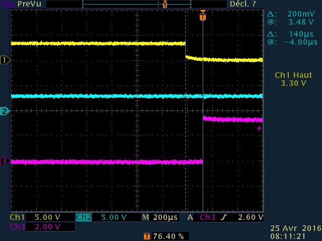

    Please find the project, and two snapshot.
    In yellow (CH1) , it is the GPIO69 pin signal which trig the interrupt.
    CH2 is the second interrupt, but disable in my tests.
    CH3 is the DACB output of the evalboard IDDK Rev2:
    I Set Dac out to #1000 on Begin of the interrupt source code (&ESCIsr), and set to 0 at the end of it. (We can see when this run correctly, the GPIO69 signal is acknowledge thank to work done in the ISR.
    On the ground task (450µs C0 task), I pull  the GPIO69 state, if it is to 0, I set DACb to 4095...
    Pjt.rar
  • Same with a large base time to see on interrupt Ok and the next where ISR routine never called.
